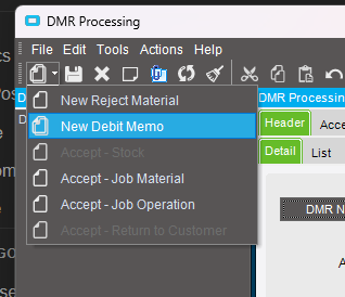

Your process is pretty much what we do except once the parts are reworked, Quality would use Job Tracker to total up the labor hours, multiply by the rework rate, and then enter the debit memo request on the original DMR for AP to then process. We wouldn’t create a new DMR just for the debit memo.

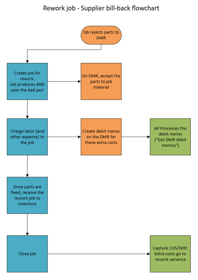

OK interesting. So your DMR has
  1. An accept to material for the parts and
  2. A manually-created debit memo for the money to bill back?
(Not a memo created off of the “return to supplier” option, right?)

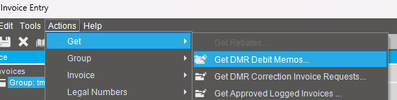

Right. Quality would enter a New Debit Memo in DMR Processing which then shows as open in a few different reports for AP and lets AP pick the DMR in Invoice Entry > Actions > Get DMR Debit Memos.

That’s pretty solid.
So in the end the DMR is the central hub to track stuff down (by BAQ - ain’t no way a person could follow the trail out of the box). I was mentally centering it on the job.
OK, I like this!
Made a swim-lane chart.

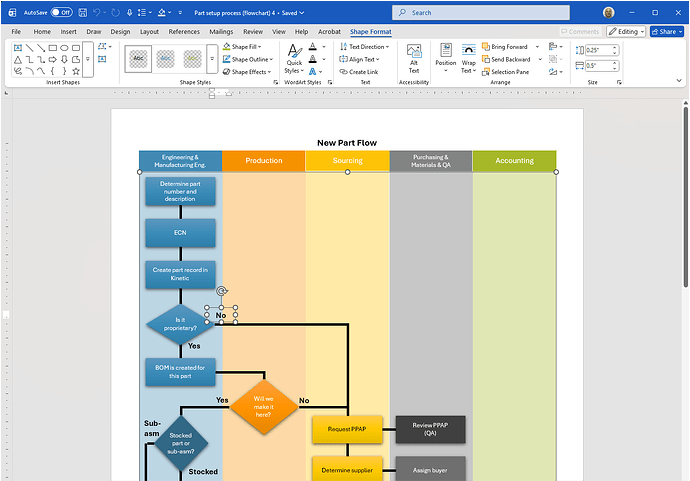

Last time I used Visio - a year ago - I remember thinking it was easier to do a flowchart by just making boxes and arrows in Word or PowerPoint. Because I did that:
But now (in M365 anyway) the canvas is infinite and you can kind of rescale it. By default the font is 8 pt (WHY?) but that is easy enough to overcome. And the arrows connect cleanly. It’s lightyears ahead of whatever I tried to use last year.
I might actually make these more often now.
