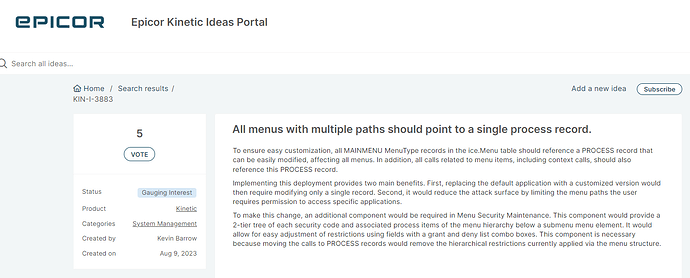

There are many Kinetic Ideas to vote on for Menu Security, so search there and vote, but I believe this one reflects this particular request you have, and is a good one.
That’s not perfect but close enough to improve the security situation. I’ve actually searched for this before because the security methods make me sad but never turned this one up. I’m off to go vote and comment. Copying below…
