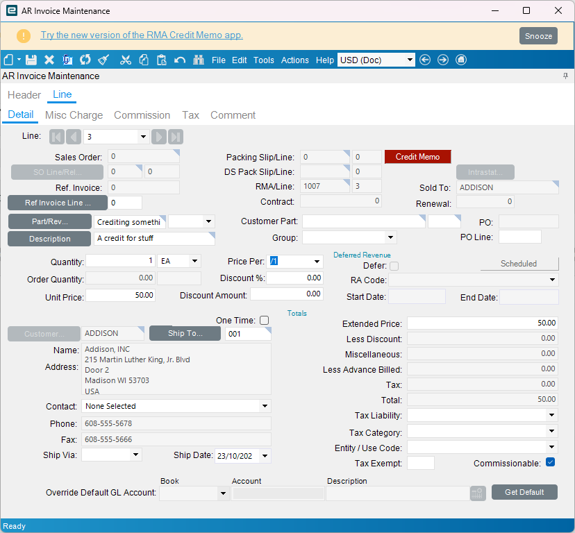

Ok RMA aside how does a credit memo work against and invoice? A bit of testing on the RMA, you can raise a credit memo for an invoice, add an line then put in an a bogus part number description and reason, then go and click on the Credit button and it will create a credit memo the product group is empty. You don’t even have to receive of disposition the RMA, just close it, then you can pick up the credit in AR invoice entry.

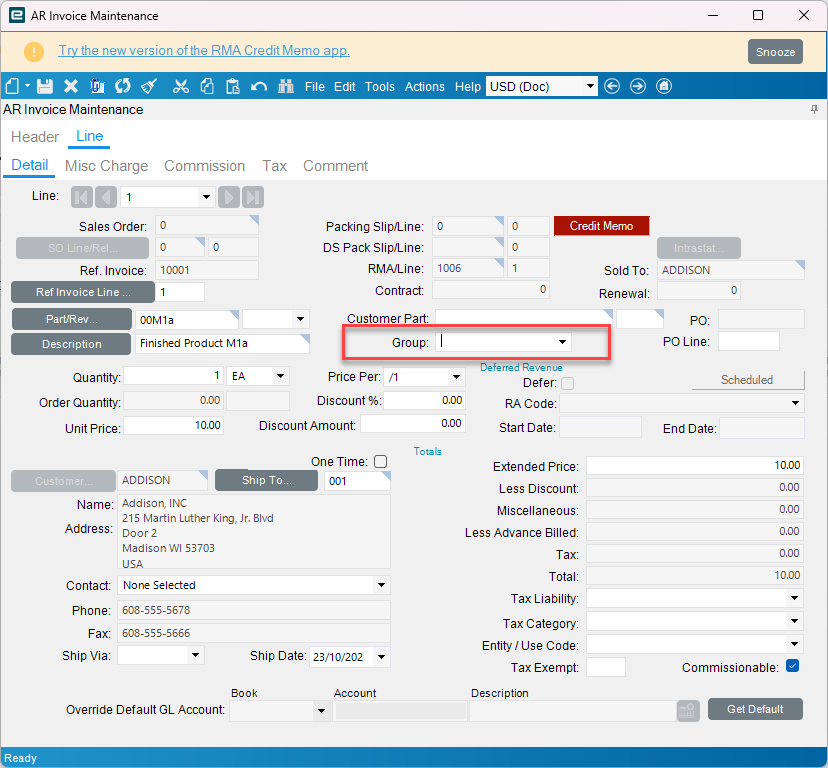

I did a few scenarios in the education system. In the first instance 00M1a has no product group and the credit screen on in RMA entry reflects that

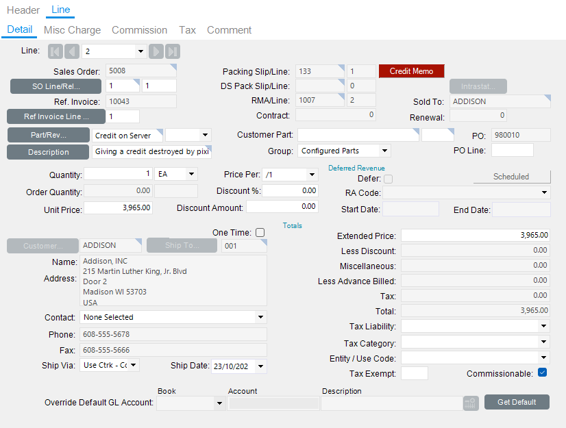

Second I picked up another invoice and selected the line and the part had a product group.
and finally I just added an RMA line gave it a qty and a UOM, used a bogus part and description and got no product code.

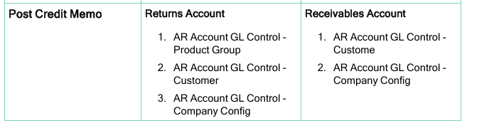

I have not posted this yet, but based on the AR Hierarchy tech doc it clearly states

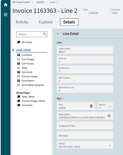

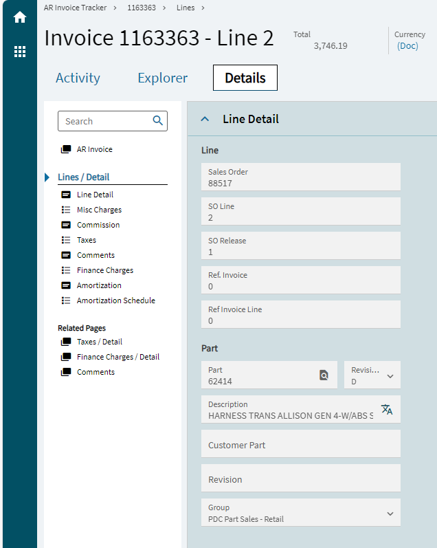

Here is the original invoice:

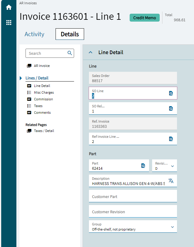

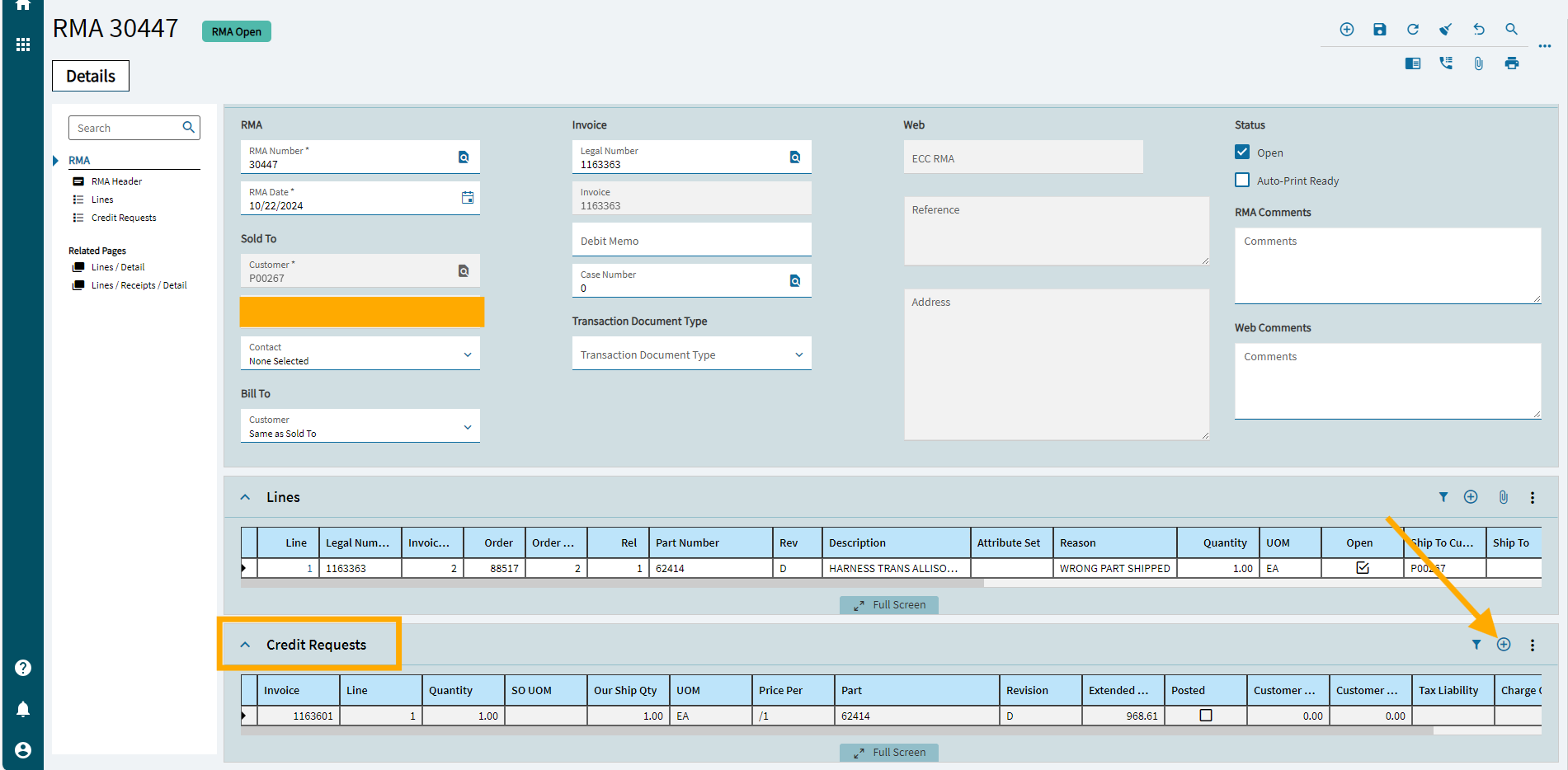

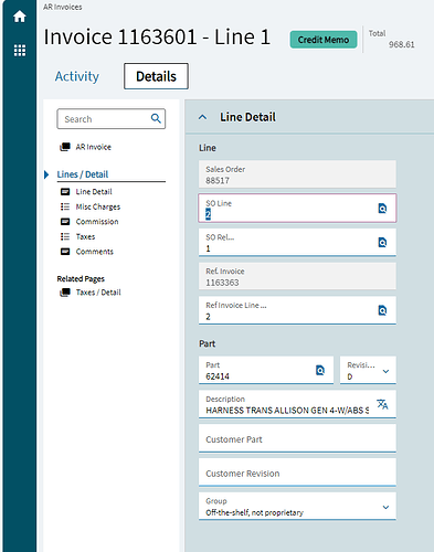

Here is the RMA CM (I only did line 2):
Groups are different.

So invoice is getting the group from the SO, and the credit from the part… I think we know the answer.

Maybe this is not common knowledge, but there is a button in the RMA screen that creates the CM for you.

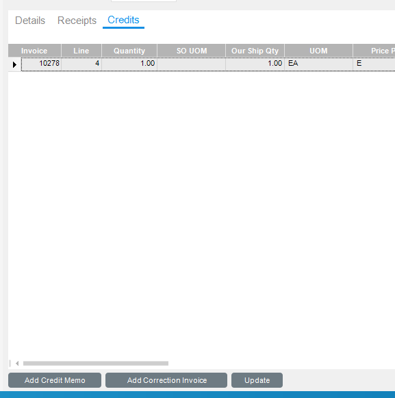

Yes I was using classic and its down the bottom of the credtis tab, that’s what brings up the MDI RMA credit window, it is specific to RMAs

So the reason why the product group is taken from the part and not the sales order is because you specified an Invoice Number/Line.
If you enter the sales order/line/release only, then it works as expected, but as far as I can see that also changes how some information on the credit memo is calculated/defaulted.

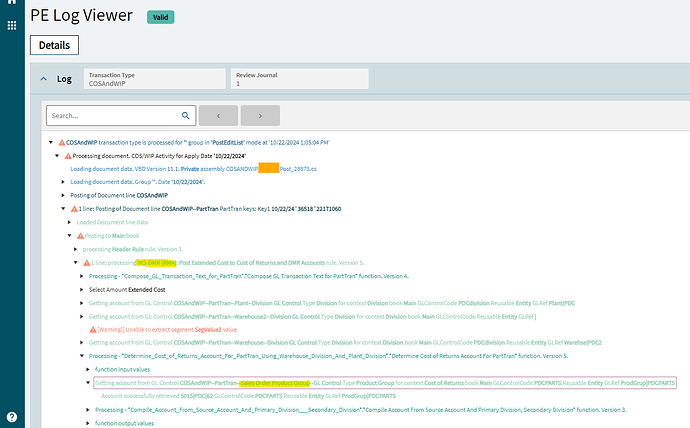

It’s the INS-DMR transaction that I am referring to. (Aka the RMA disposition.)
Even when I reference the invoice (not only the order), it grabs the product group from the order. (That’s good.)
Here is PE Log Viewer to prove that I didn’t just guess at that:
