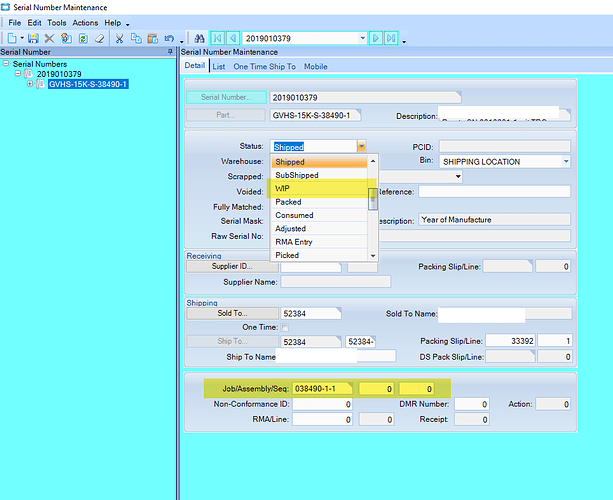

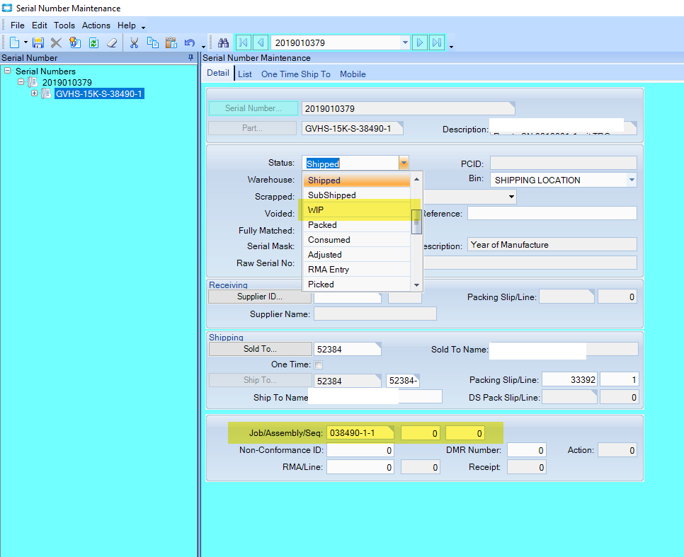

Have you tried going into Serial Number maintenance and change the status of it to WIP and provide associated Job no / mtl / seq data? That might free up the SN to allow you to salvage it off the job for the part no. I have never seen messing with SN cause any cost or inventory adjustments. The part number on / off job, shipped out, received back in via RMA, they all impact accounting, but not serial number acrobatics.
I tried every status in Serial Maintenance but it seems the Job Receipt to Salvage only wants to create new SNs not adjust previously added ones.
However I found that I can do a ‘Return Miscellaneous Material’ if I set the status of a serialized part to “Misc-Issue”, and it lets me put that part back into stock. Unfortunately, it seems that this transaction does not involve costs and so it’s basically the same as doing a Qty adjustment, just tied to the job.
