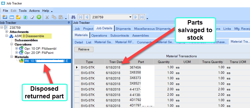

We do disassembly jobs with returned parts disposed to “Disassemble” ( a “placeholder” part) and salvage the parts to stock. What am i missing?

Yes, an RMA is used. The part being returned is disposed to job via RMA disposition (mtl 10 in screenshot). This places the cost of that returned part on the job. Salvage to stock transactions off the job take the parts with associated inventory value from the value of the disposed part. We have noticed that if costs are accidentally zeroed on disposition then cannot take parts with cost off via salvage to stock.
Nancy

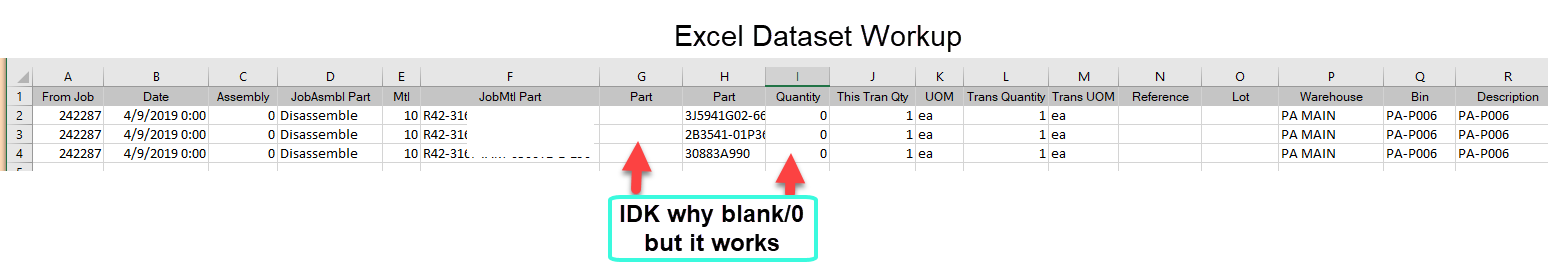

Hi Mark,
I couldn’t find old upload, but played around with it and see that it works. It doesn’t look like it’s going to work, but it does, at least in 10.1.600.20 :slight_smile:
Here are the details. The job is making a part called Disassemble, the R42-31… part is the one being disassembled, it is mtl 10 on the job. The “H” column Part data is the list of parts being pulled off and their Quantity and UOM are in J,K,L,M. I tried making it simpler, pasting less but it kept failing. So, I figured WTH just paste it all. Having to put Bin in is a bit of a hassle, you might need to get the primary bins to do a good job on that. It fails without bin.
Note, you cannot pull more cost off the Issued part for disassembly than it’s worth. There is another tab in Job receipt to salvage for Costs… perhaps something could be done there if necessary…
Nancy

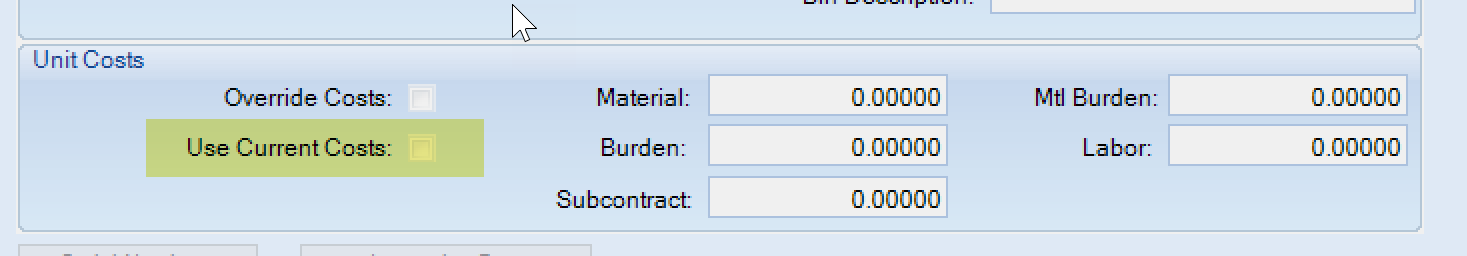

I just had an issue with this, the part master had a phantom BOM so the RMA pulled in the part with no value even though the original job had materials added. I used the “Override Costs” checkbox on the RMA disposition to add value to the part. I am wondering if that is the correct approach ?
Hi Evan,
I’m not sure why a phantom bom part number would not have any cost on it in the system. I just checked some of ours and they have cost. When I did RMA for it though it came in at zero and I checked Use Current Costs and it filled out the data. If that didn’t work, i think that Override Costs and type your own in should work ok. This is when I usually go to accounting and ask them to look at whether what we’ve done has caused any unexpected accounting difficulties :smile:
It depends on what your costing method is. If you are using average costing, you probably won’t have any inventory transactions against the phantom part, so there won’t be any (average) cost.
Ah that’s it. We use standard cost.
Thanks Brandon!
OK, sounds like I did the right thing then. Thanks for responding. Quite convenient that this feature request thread appeared the first time I needed to disassemble a returned part. :slightly_smiling_face:
