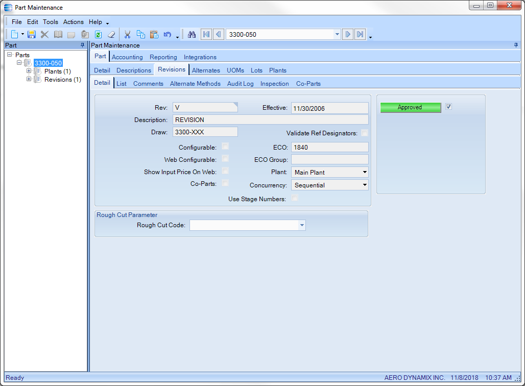

And the Rev’s are approved for the zeroed items?
Yessir, and only one approved rev per item.

Cool. And no weirdness with effective dates where another rev would be effective during the cost roll?
No, nothing weird like that. Have you ever heard of this before?

Only approved Part Rev is in the future. Cost Roll Up posting date is 1 November 2018 but rev goes into effect 7 November. So while there are parts on the MOM, they are not in effect on the roll up date.

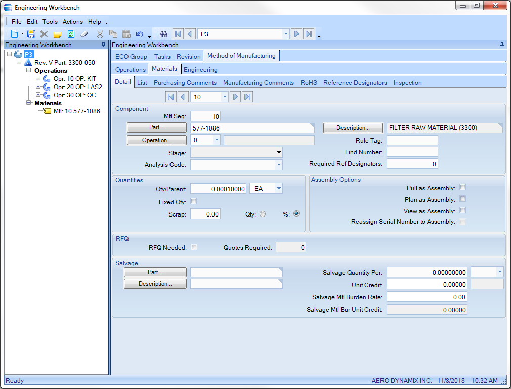

The Mom contains purchase parts with no material values and/or no hours.
Mark,
Here is the material portion of the MOM
Sorry for so many separate emails but the site only lets me do one image at a time.
Qty = .0001 EA per parent? What is the cost of the component?
…Tim
I’m with @thager. That’s a really small number unless the raw material is very, very expensive.
The component is a sheet of raw material at $529 per sheet, so we should be at .05 per piece.

All I can think of is to make sure your standard cost on the component is actually $529 and that the component costing method is standard.
I have to say that even in E9, the on-hand qty should not make a difference. At least I have never seen it happen. You should be getting a roll up of $0.0529 per piece. There needs to be some other reason.
I would look at the costing method of the material and what that cost is and then the costing method you re using for the rollup in the costing workbench and the cost of the material for that method.
If the costing workbench is using Std, check the std cost of that material. Average, Last, etc.
If you check the checkbox for use the material costing method. Check that.
Make sure you have the materials listed in the materials tab and what the cost for the material shows before the rollup.
If all of that jives, I’m stumped and would have to stop by and look at it. I’m in Fort Worth.
