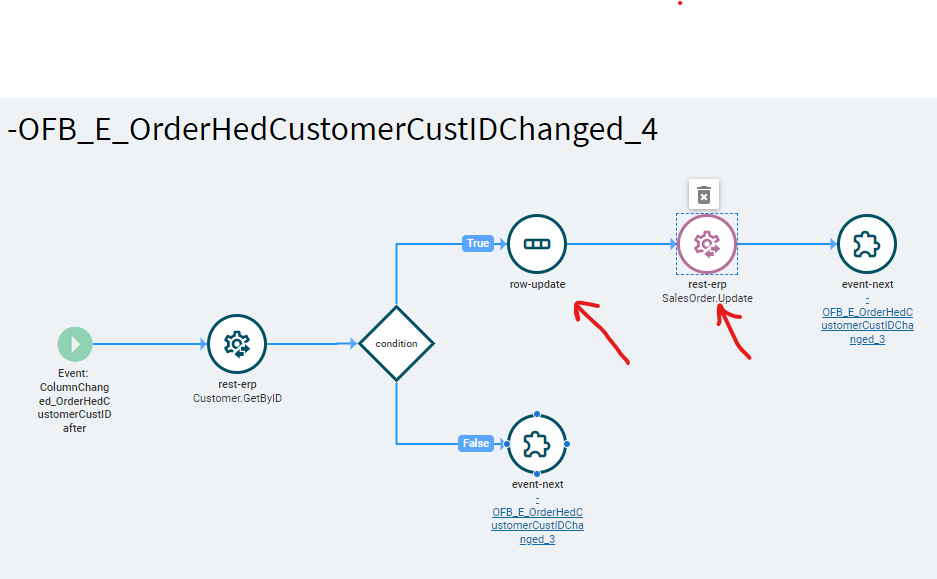

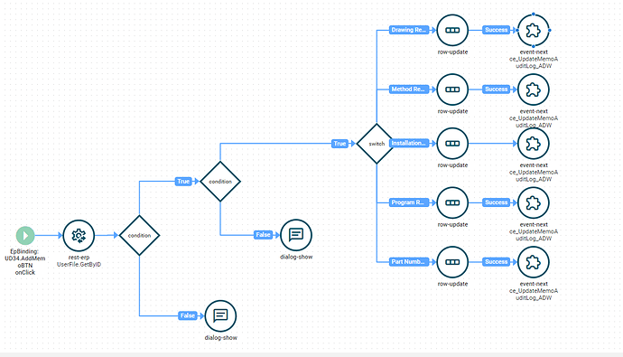

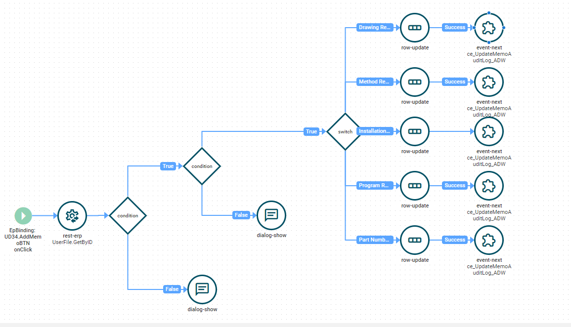

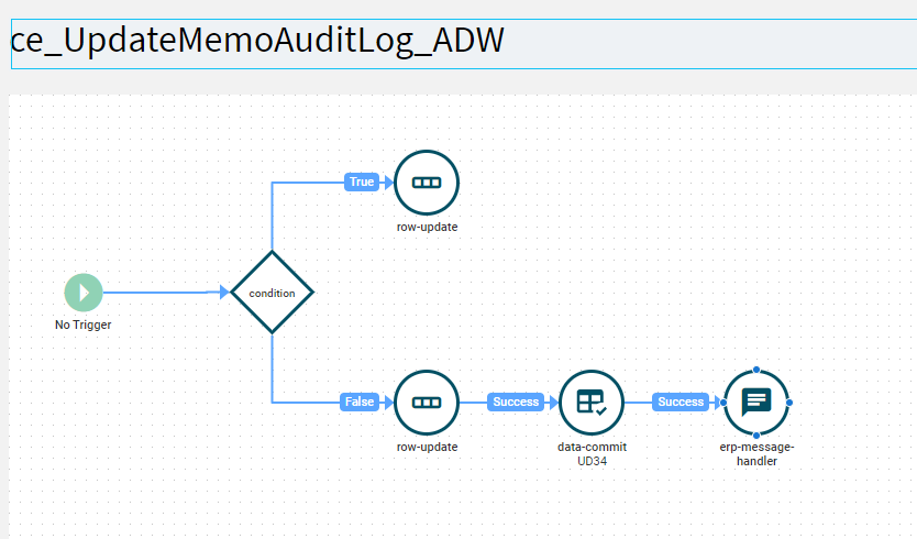

Can you please give the graphic of the whole event?
I am curious to see what the event trigger hook is.
Sure thing. There are row-updates on both sides of the event I posted further up.
They all initially show the fields being updated in the GUI, but if I leave the record and go back in, they are all blank again unless I hit Save before leaving.
I completely misunderstood the original question - I thought that the dataview itself is not updated with the new values :slight_smile:
Are you saving that it shows you the updated values on the screen, but they are not really saved unless you hit the Save button?
If that is the case, that is because there is no Ice.BO.UD34Svc::Update call made in that flow…

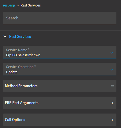

I have this situation with a row-update and I want to call SalesOrderSvc.Update with rest-erp thingy but it wants a dataset as the parameter, how do I get my dataset when I’m in dataview land ?
If I recall, you put the name of the view in there.
Like this:

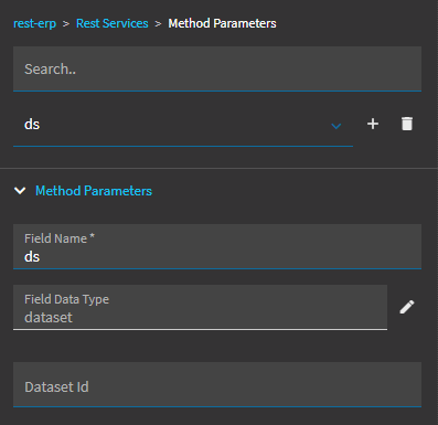

Hmmm, I’m not sure, here’s more detail of what I have:
my row update updates a field in OrderHed, then my rest-erp is calling SalesOrder.Update which looks like this:
and

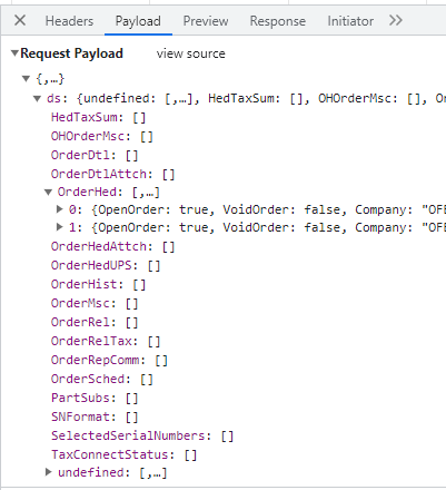

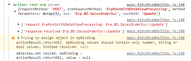

but when my update call is made this is what I see in debug:
looks kind of normal but my payload ds looks like this on the network tab:
(response is empty to but I did not really need the response

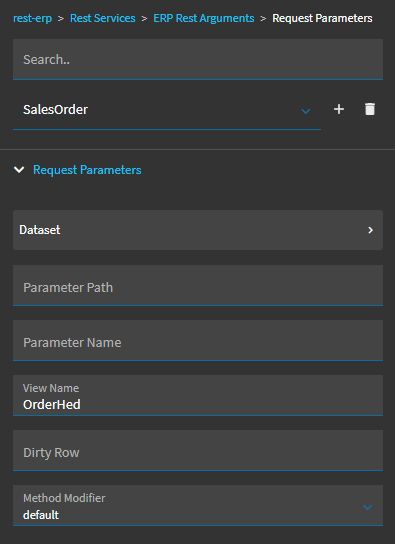

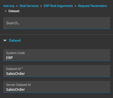

I think there’s also a request params spot you can specify it. Try there.

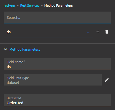

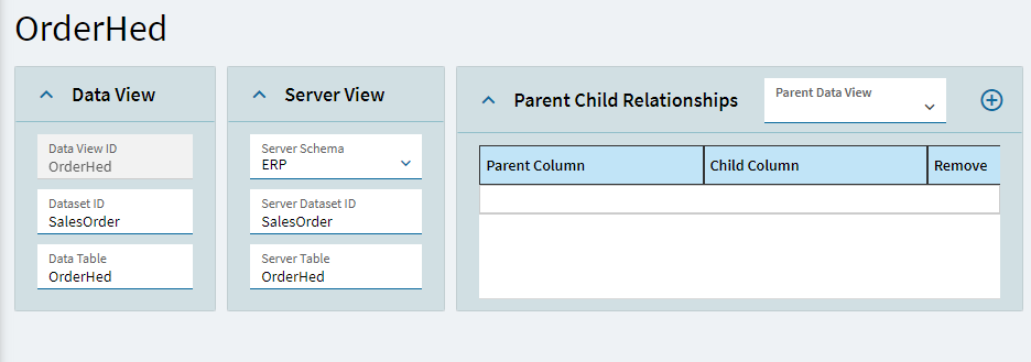

wowza, this is what I did:
based on this stuff for OrderHed dataview (Dataset Id’s)
my rest erp setup continued is:
and:

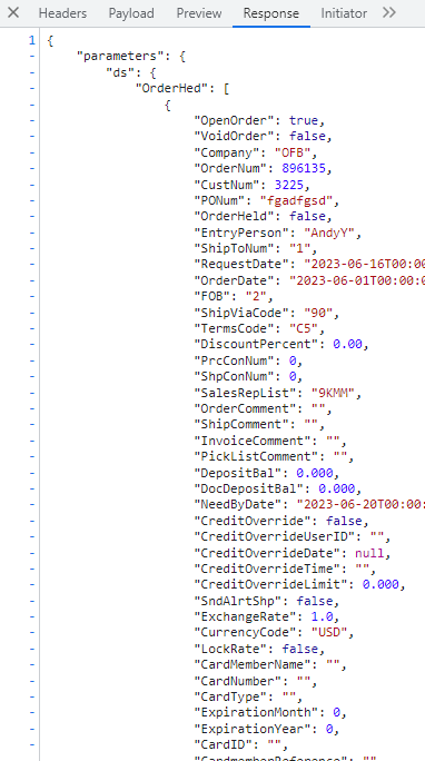

I got a payload and response:
payload, interestingly has the before and after OrderHed record
response has the modified record only:
I have to do some more testing to verify it all, but looks very promising

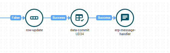

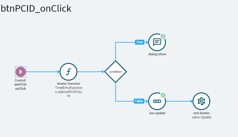

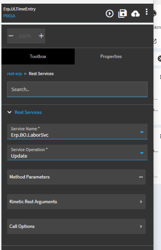

When I used the Kinetic Rest widget it seemed to fail silently which is odd because if you choose the wrong BO (like the LaborDtl BO instead of the Labor BO) it fails spectacularly.
Solution:I removed the data commit widget then the rest widget was able to update the labor.
I vote Kinetic gives us a save widget lol
In short if I click a button it pulls the next available PCID for the job using the return value to fill in the labour part column
