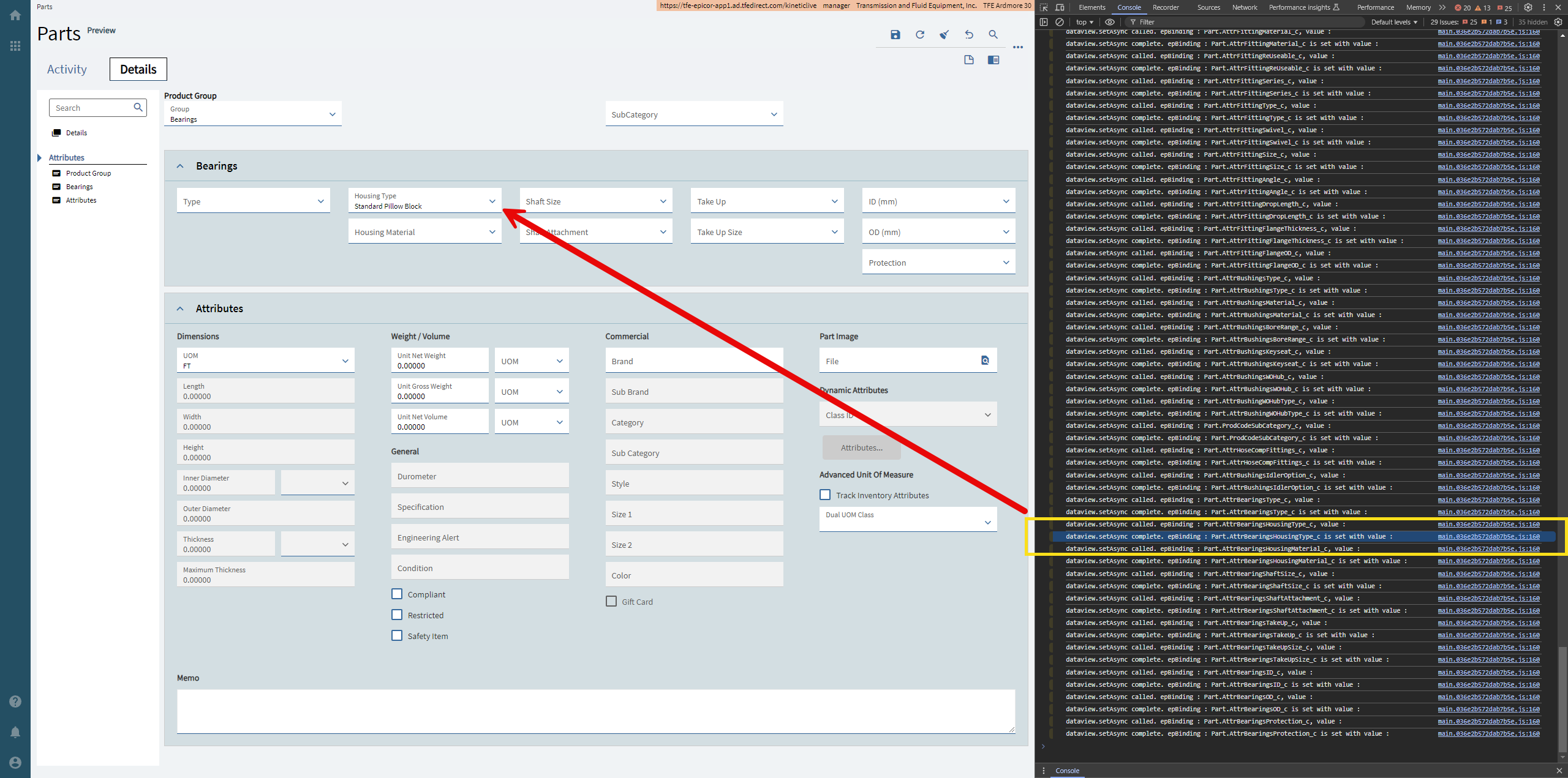

I am customizing the Part form, I have an event that should remove custom attributes on ProdCode change. It’s firing, and on save the fields are blank, but the interface is not updating. Thoughts?
In this example the Housing Type field should be empty after I switched the Product Group selection.

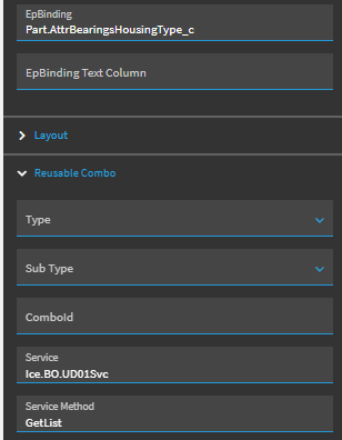

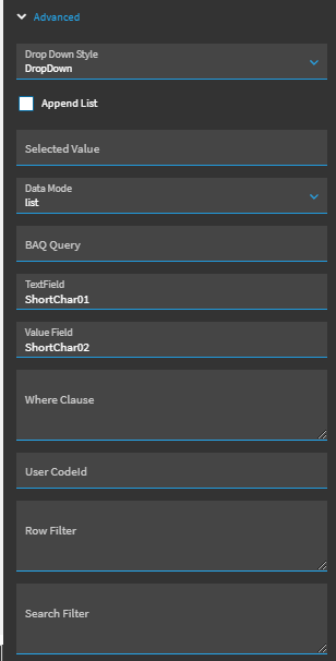

What are the settings for that combo box? Under Data, Reusable Combo, and Advanced.
That all looks right.

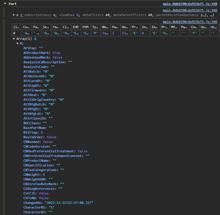

What should I be expecting to see here? I can see that Part is dirty (red right?)
You want to expand this.
That will show you all of the records in the dataview. You also want to check any other dataviews that might be involved in the process. Is your UD table getting stored in a dataview? Are there any REST calls that still hold data? etc.

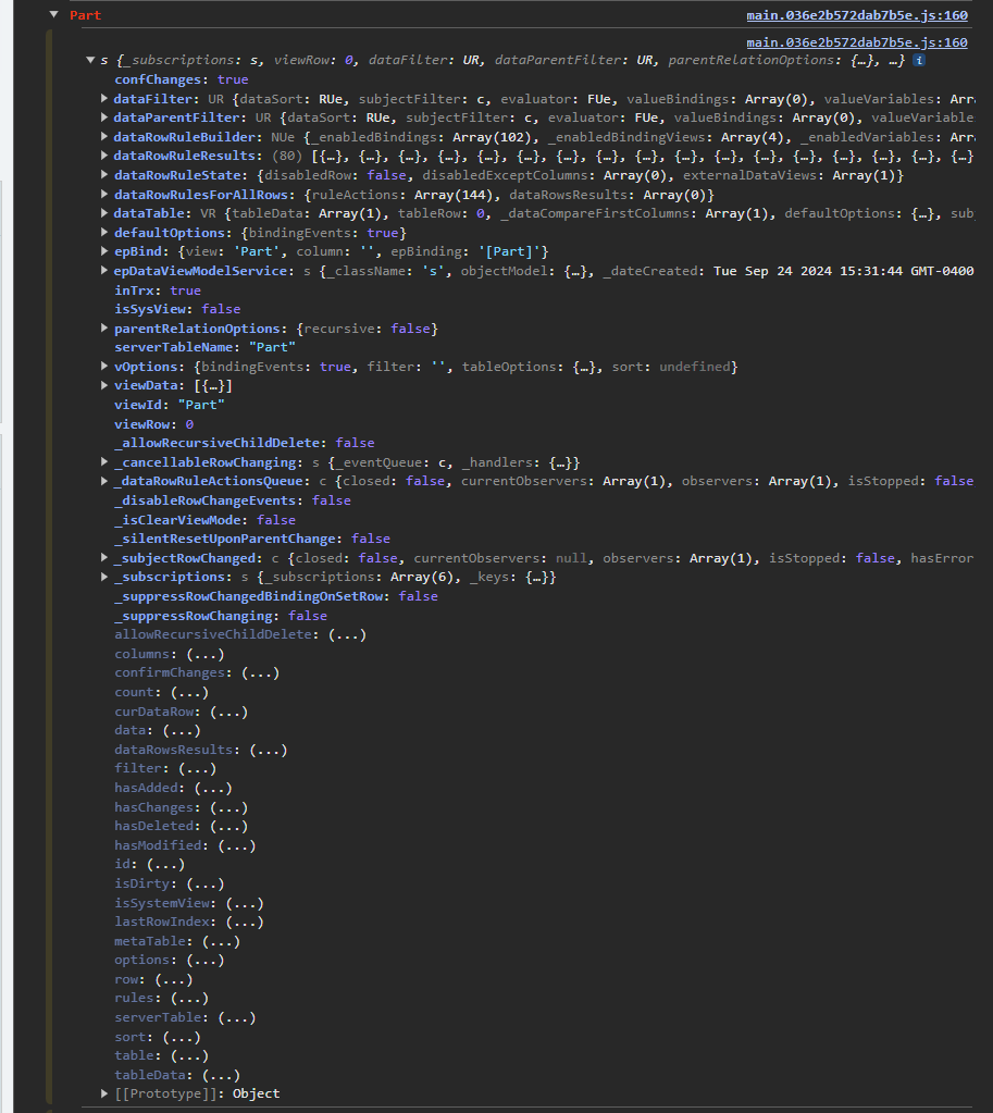

Instead of expanding that top object, expand Array…
There you should be able to see all the values in the data view:
