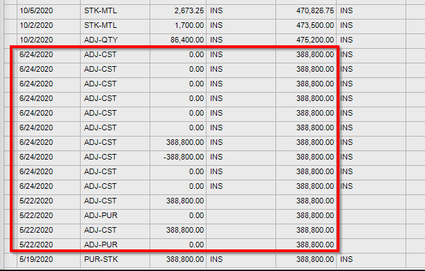

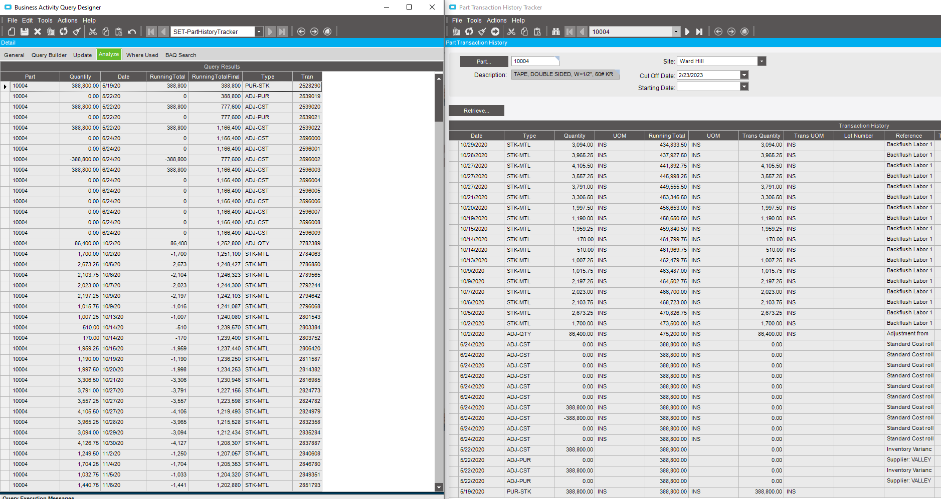

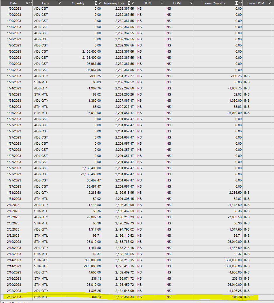

In the tracker I have this amount:

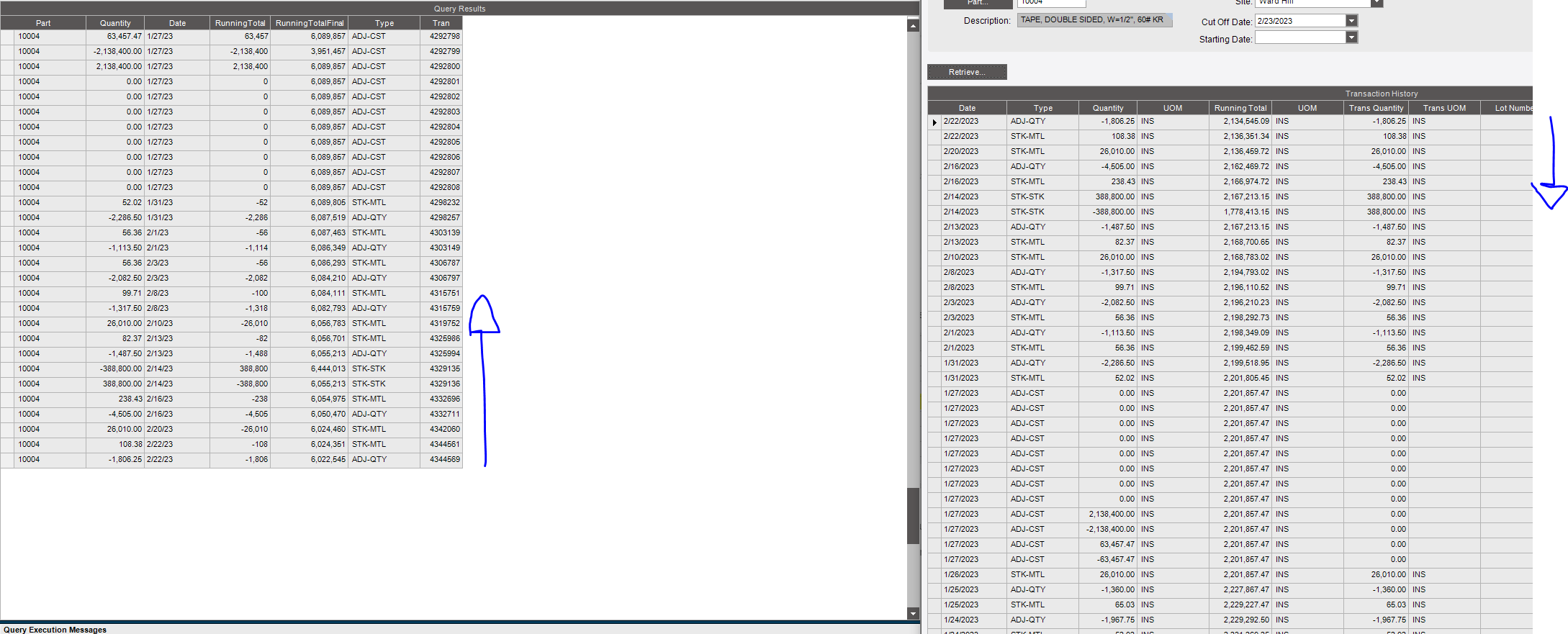

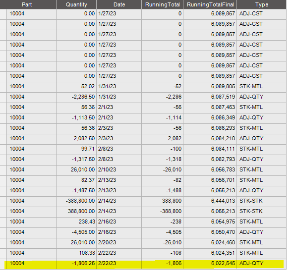

But in my BAQ I have this amount:
What can I be doing to begin to check why this may be wrong? The number of records returned by both are the same so I assume it may be the TranTypes that may be messing it up. Any thoughts?
