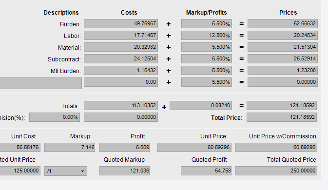

Are you asking about quoted costs and profit from the quote tracker worksheet screen, like below?

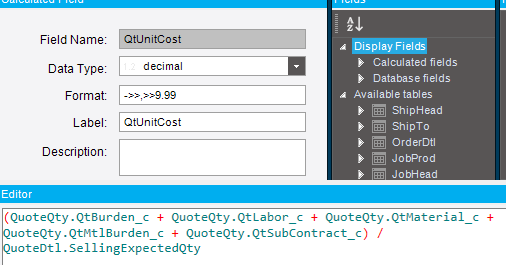

This is what I was referring to when I was working on this project. These are temporary calculated fields, so you’re not able to find them in the Query designer by default. What I did to get around this was to create new custom fields on the QuoteQty table (QtLabor, QtBurden, QtMaterial, etc) and then customized the quote entry screen to populate those fields when the “Quoted” checkbox becomes checked or the quoted qty is changed. Then I was able to use those fields in my query.

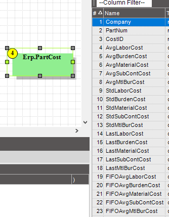

Have you looked at the PartCost table to see if it has any costing data?
