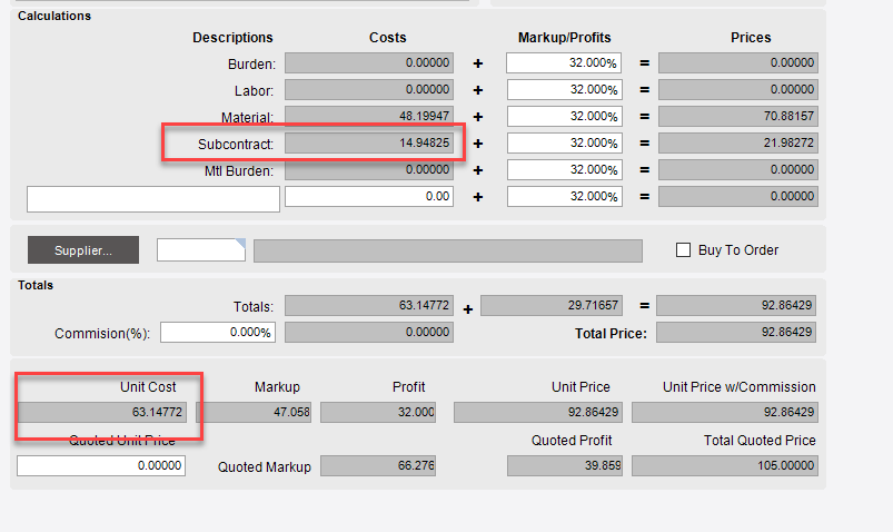

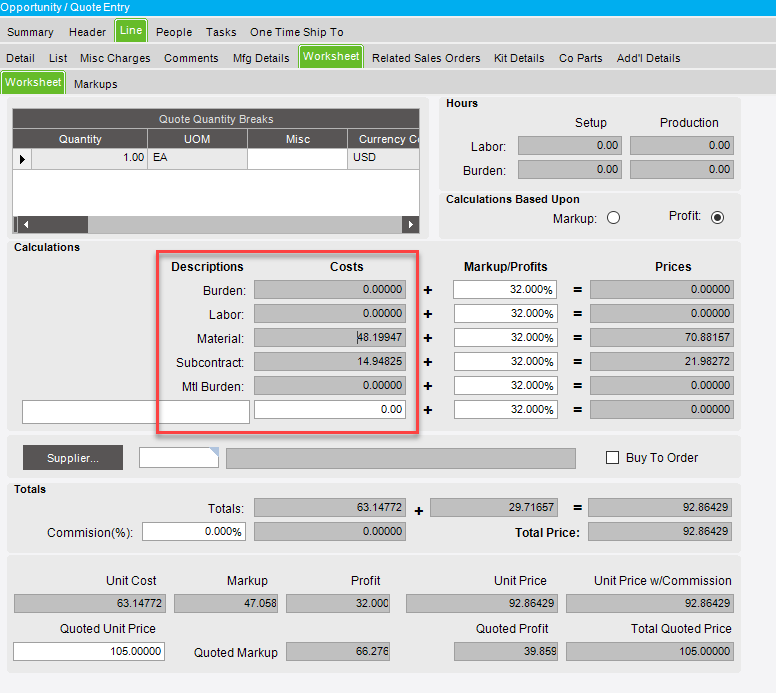

Is there any way to access the quote worksheet cost fields?
If not, how are they calculating those costs?
The unit cost in this image shows 63.14772, but the costs tab in Part Tracker shows 54.8774.
I’d like to use those fields in a BPM.
I had to calculate them for a BAQ.

I tried that, but was getting off results.

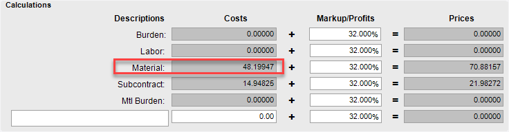

We have 4 material lines on this one totaling to 63.14772, but the material on the worksheet shows 48.19947.

Even more interesting, this part is showing subcontract costs. There’s no subcontract operation.
The total unit cost is exactly the calculated material cost I’m getting manually. Why is the subcon randomly broken out?

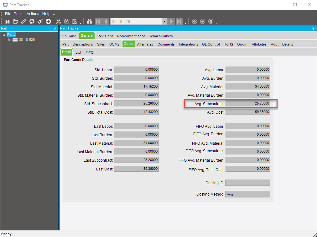

If you look at each raw materials from the part tracker, under the costs tab, are they showing values in the subcontract cost bucket? Even though, I feel like they should be considered as material costs in the quote, but we never know…
Hmm, yes I see it there, but it’s not the 14 dollars in the worksheet.

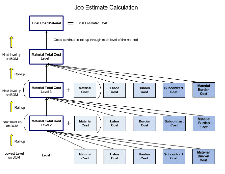

Aaron it all depends on how you want epicor shows your costing. If the raw materials receive any treatment or they are subcontract materials and you pass them there are to ways they will flow into the next level, this is default
Which everyone would assume, BUT there is another one called SPLIT COST ELEMENTS
So if you have it turned on and some of the previous materials get any subcontract cost, it would explain why you have OV cost even thou the part your are quoting does not have at that level
