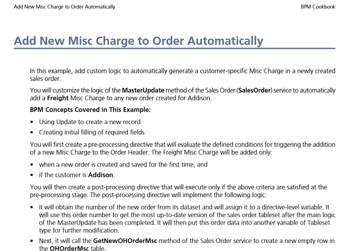

Sales Order Header Misc Charge (BPM AutoAdd MiscCharge at Order Creation)
I would like to create a BPM that will automatically add a particular MiscCharge to the Order Header at order creation.
Are there any help documents out there that would help me through this process?
I did the Trace, but all the methods I have tried did not work as expected.
Thank in advance.
This specific requirement is in epicweb BPM cookbook.
https://epicweb.epicor.com/doc/Docs/Kinetic_bpmcookbook_2021.1.pdf
Thank you SO MUCH!!
That was Perfect!!
