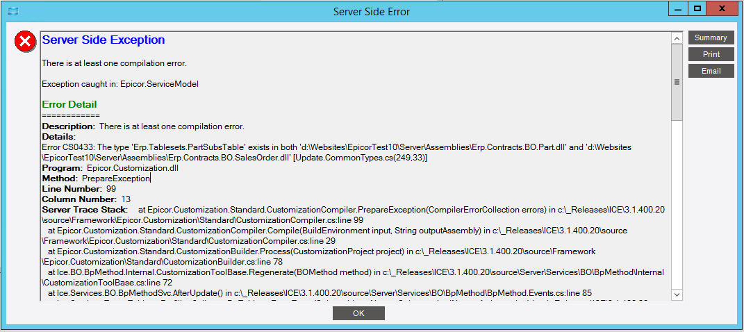

Same class different DLL's
This happens all the time in E10 when you are trying to call Business Logic from from multiple BO’s in the same piece of code. For example of you are trying to modify Part properties from within SalesOrder.Update. Both the Contracts.BO.SalesOrder.dll and the Contracts.BO.Part.dll define the PartSubsTable class and the compiler doesn’t know which class you are referring to when using them so you get this error.
This gets particularly dificult when you are have more than 2 DLL’s that share the same class (dare I say SelectedSerialNumberDataSet which is defined in no less than 10 different DLL’s)
In standard Visual Studio you can get around this by defining an alias for the class but this is done at the project level and there is no way to do that with the dynamic compile projects in customizations and BPMs.
Has anyone else run into this and come up with a workaround? Currently the workaround that I’ve used is to move all my code to an external DLL that does the work,but that complicates the deployment and requires more maintenance.
