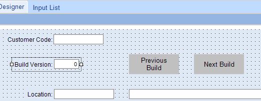

We have 4 product configurators. They basically look & feel the same.
Sales enter a customer, then chooses a configuration. this then generates the ‘customer code number’ and this is then read off a look-up table.
We have a character box to manually enter in the configuraiton number.
We have 2 buttons on the configurator screen; one will increment up this number, the other one will increment it down.
On the 4 configurators we have, it work. but on the 5th one, the one I’m building, I can see the number increase or decrease, but nothing changes.
I can, however, enter in the desired number, and it will update itself. SO, I’m at a loss as to why it works on one, but not the other…

As I said, this works find in 4 other configurators, not the 5th one. This works (albeit slow) when I manually type in a number, but not with the next / previous button (I can see the number increase or decrease, but it just doesn’t seem to trigger the next build, to get the next line of look-up table data…)
Its there a limit to how many lines I should have in my code?
Does it time out after a while?
Is there a way to see where it’s pausing? Or what event is slowing it down?
