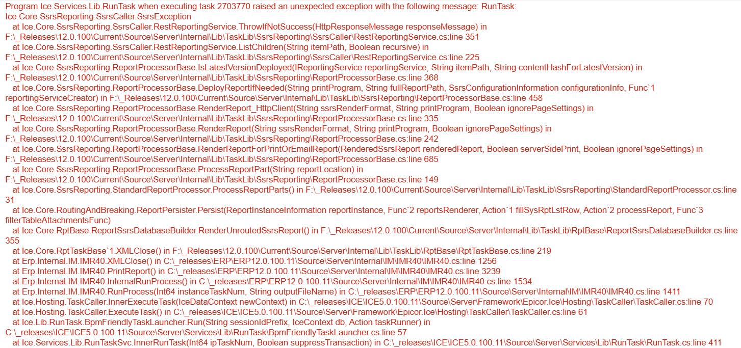

Users still getting massively slowed down by the Epicor Cloud SSRS Printing. Got a new error today, though. Anyone seen this one before?
Program Ice.Services.Lib.RunTask when executing task 835028 raised an unexpected exception with the following message: RunTask: Ice.Core.SsrsReporting.SsrsCaller.SsrsException at Ice.Core.SsrsReporting.SsrsCaller.RestReportingService.ThrowIfNotSuccess(HttpResponseMessage responseMessage) in C:\_releases\ICE\ICE5.1.100.7\Source\Server\Internal\Lib\TaskLib\SsrsReporting\SsrsCaller\RestReportingService.cs:line 351 at Ice.Core.SsrsReporting.SsrsCaller.RestReportingService.CreateCatalogItem(String ItemType, String Name, String Parent, Boolean Overwrite, Byte[] Definition, Property[] Properties, Warning[]& Warnings) in C:\_releases\ICE\ICE5.1.100.7\Source\Server\Internal\Lib\TaskLib\SsrsReporting\SsrsCaller\RestReportingService.cs:line 82 at Ice.Core.SsrsReporting.ReportProcessorBase.DeployReportIfNeeded(String printProgram, String fullReportPath, SsrsConfigurationInformation configurationInfo, Func1 reportingServiceCreator) in C:_releases\ICE\ICE5.1.100.7\Source\Server\Internal\Lib\TaskLib\SsrsReporting\ReportProcessorBase.cs:line 529 at Ice.Core.SsrsReporting.ReportProcessorBase.RenderReport_HttpClient(String ssrsRenderFormat, String printProgram, Boolean ignorePageSettings) in C:_releases\ICE\ICE5.1.100.7\Source\Server\Internal\Lib\TaskLib\SsrsReporting\ReportProcessorBase.cs:line 336 at Ice.Core.SsrsReporting.ReportProcessorBase.RenderReport(String ssrsRenderFormat, String printProgram, Boolean ignorePageSettings) in C:_releases\ICE\ICE5.1.100.7\Source\Server\Internal\Lib\TaskLib\SsrsReporting\ReportProcessorBase.cs:line 243 at Ice.Core.SsrsReporting.ReportProcessorBase.ProcessReportPart(String reportLocation) in C:_releases\ICE\ICE5.1.100.7\Source\Server\Internal\Lib\TaskLib\SsrsReporting\ReportProcessorBase.cs:line 159 at Ice.Core.SsrsReporting.StandardReportProcessor.ProcessReportParts() in C:_releases\ICE\ICE5.1.100.7\Source\Server\Internal\Lib\TaskLib\SsrsReporting\StandardReportProcessor.cs:line 31 at Ice.Core.RoutingAndBreaking.ReportPersister.Persist(ReportInstanceInformation reportInstance, Func2 reportsRenderer, Action1 fillSysRptLstRow, Action2 processReport, Func3 filterTableAttachmentsFunc) at Ice.Core.RptBase.ReportSsrsDatabaseBuilder.RenderUnroutedSsrsReport() in C:_releases\ICE\ICE5.1.100.7\Source\Server\Internal\Lib\TaskLib\RptBase\ReportSsrsDatabaseBuilder.cs:line 355 at Ice.Core.RptTaskBase1.XMLClose() in C:\_releases\ICE\ICE5.1.100.7\Source\Server\Internal\Lib\TaskLib\RptBase\RptTaskBase.cs:line 219 at Erp.Internal.PM.POForm.RunProcess(Int64 instanceTaskNum, String outputFileName) in C:\_releases\ERP\ERP12.1.100.0\Source\Server\Internal\PM\POForm\POForm.cs:line 451 at Ice.Hosting.TaskCaller.InnerExecuteTask(IceDataContext newContext) in C:\_releases\ICE\ICE5.1.100.7\Source\Server\Framework\Epicor.Ice\Hosting\TaskCaller\TaskCaller.cs:line 71 at Ice.Hosting.TaskCaller.ExecuteTask() in C:\_releases\ICE\ICE5.1.100.7\Source\Server\Framework\Epicor.Ice\Hosting\TaskCaller\TaskCaller.cs:line 62 at Ice.Lib.RunTask.BpmFriendlyTaskLauncher.Run(String sessionIdPrefix, IceContext db, Action taskRunner) in C:\_releases\ICE\ICE5.1.100.0\Source\Server\Services\Lib\RunTask\BpmFriendlyTaskLauncher.cs:line 57 at Ice.Services.Lib.RunTaskSvc.InnerRunTask(Int64 ipTaskNum, Boolean suppressTransaction) in C:\_releases\ICE\ICE5.1.100.0\Source\Server\Services\Lib\RunTask\RunTask.cs:line 349

Yep. On a scheduled monthend stock status report on 1/1.
Screencap inside.
I uploaded a file of 741 ssrs errors last week. I’m sure that one was among them. Only response from support was about completely unrelated BAQ errors in the admin logs.
