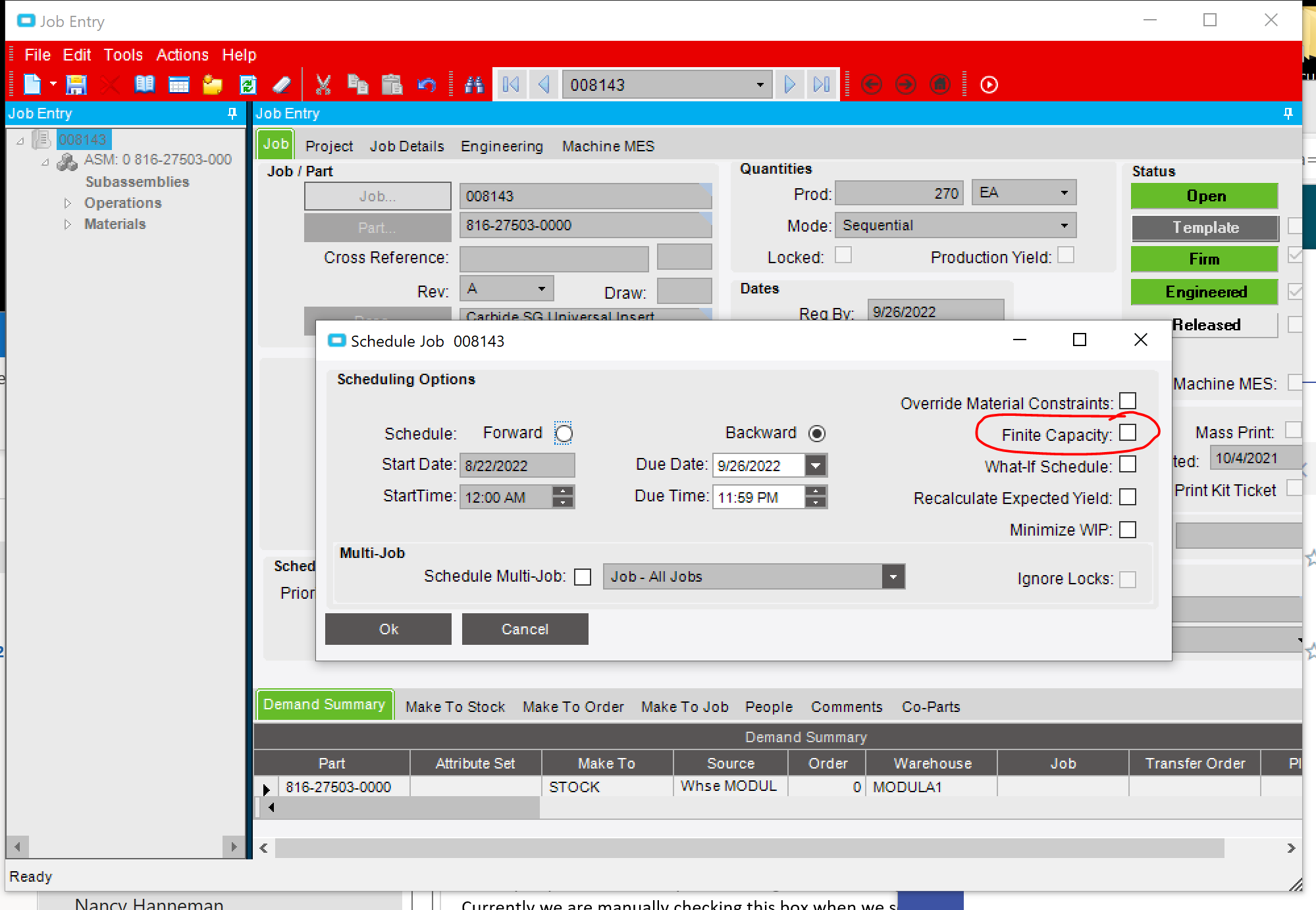

Schedule Job popup - save defaults?
When we schedule a job from job entry the Schedule Job window pops up. We would like the “finite capacity” box pre selected. When we right-click and save layout, it never stays checked. Is there another way to save this as a default?

In the job schedule customization, from the wizard, add an EpiViewNotification form event for the ScheduleEngine view. Once you do that, in the code generated, change the NotifyType to NotifyType.Initialize and add the line of code as below:

Actually, the users cannot “uncheck” the box now. They want it to default to checked, but also want the ability to uncheck it. Is there something I can change in this code to make that available?

You’re right. That’s because, as soon as you uncheck the option, the EpiViewNotification event fires again and checks it back. Forget about the EpiViewNotification event, the one below for the Form Load seems to work and it does let me uncheck it.
