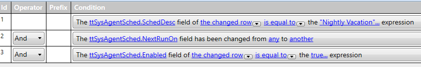

We’ve very recently completed our Cloud migration and we have an issue with a few of our BPMs. We have them set up to run when a schedule’s NextRunOn field changes, and before our move this has always worked to schedule these BPMs to run every night. Since our move to Cloud, they haven’t been running at night, and we’re not sure why. I can change the NextRunOn field manually and this will trigger our BPMs, but at night when the schedules tick over themselves, it doesn’t seem to cause the same database update we look at as before.Does anyone have any insight to if something is different between On-Prem and Cloud when it comes to the System Agent Tasks? Here is an example of a condition in our BPMs that used to work.
Data directives can no longer be used on the systask table in the cloud. You will need to migrate your logic into a scheduled function.
EDIT:
oh wait this is sysagentsched hmmmm either way I think it would be best to move your BPMs into a scheduled function.
