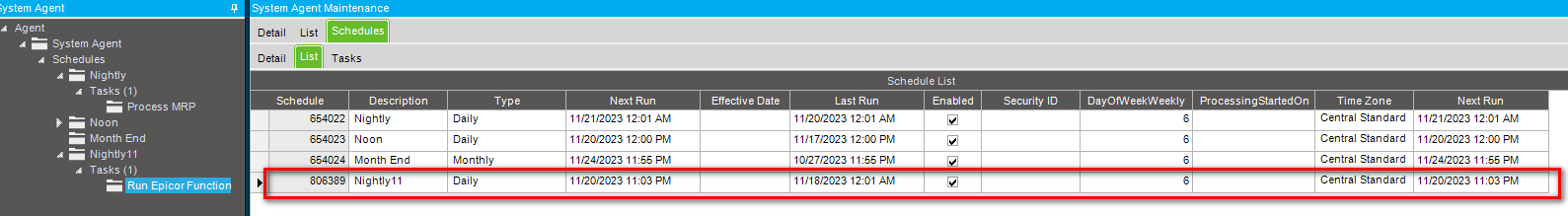

I created an Epicor function that I want to run once every weeknight. I created a new schedule named “Nightly11” which is scheduled as a Daily schedule and runs M-F.
I submitted the task to run on the new schedule and checked the box for recurring. For some reason, it runs every two minutes until 12:01 AM.

Are you sure you selected the right “schedule” when you scheduled it?

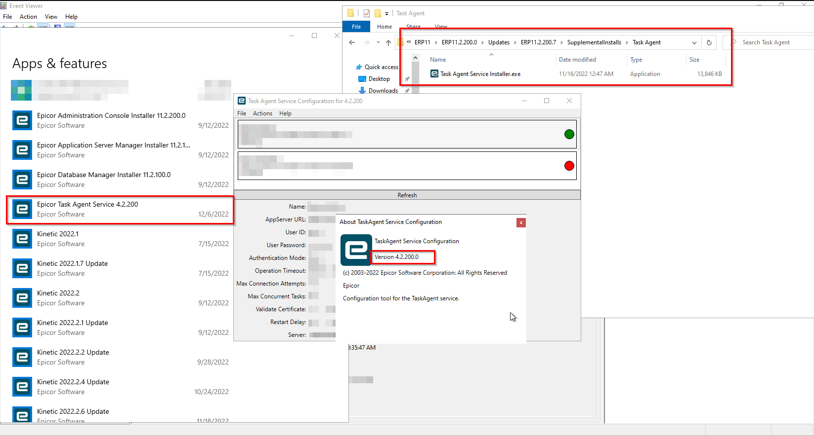

Ensure running absolute latest version of task agent you can. There is a bug with timezoning that can cause this.
@josecgomez Thanks for the quick response! I’ve verified that the function call is on the correct schedule

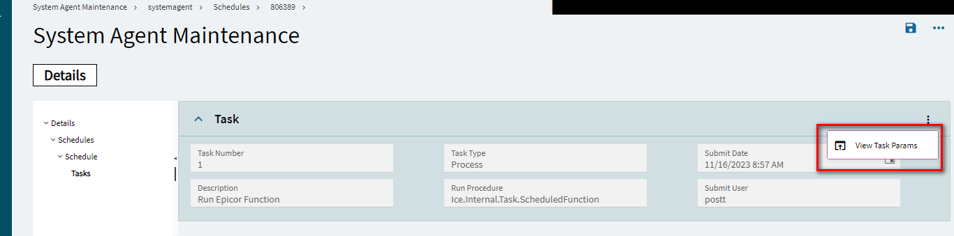

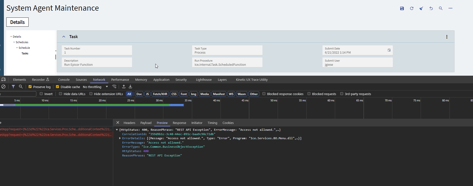

Unfortunately I’m not able to view the task parameters in classic due to a missing DLL and when I choose them in Kinetic, nothing happens. Maybe that is by design since there are no input parameters to the function.
@jgiese.wci Thanks for the linkI did not see that before posting this. I’ll take a look at that

I believe this was fixed. BUT, any pre-existing tasks have the incorrect URL/DLL info stored.
Try removing the task from the schedule and re-adding it. If you’re not sure what parameters it runs with, check the SysTaskParam table first to grab the settings you need.
