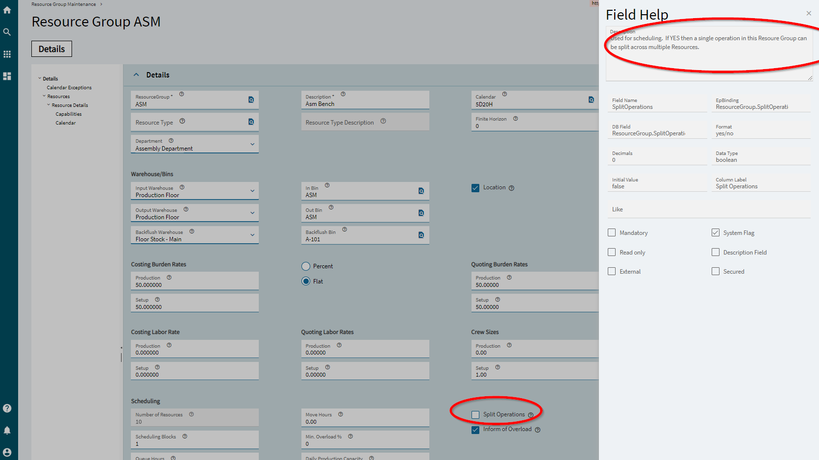

It looks like I should be using multiple scheduling blocks and split operations for the machine’s resource group. I set my scheduling blocks for the machines RG to 2, and I turned on split operations. But when I reschedule the job, it is still just putting one day shift person on the operation for all 40 hours.

I think that this might be the magic you are looking for… it has been a while since i tested this, but if you allow split operations, then i believe that the system will allow the resource to change across shifts/days.
I turned split operations on for our Machine Operators resource group. By itself, this does not seem to change the way a job is scheduled. I am looking at op 30 in a sample job, where the operation will take 40 hours. The schedule books one machine from the mills resource group, and one machine operator shift from the MO resource group. It books the one night resource (in this case the op starts after day shift ends), for all 40 hours of work, split over four ten hour night shifts.
So I tried changing the number of scheduling blocks to two for op 30, thinking that it might allow what I am trying to do. Instead the schedule just assumes we now have the ability to split the operation between two resources. So it books two different machines and two different night shifts. It runs for half the time, finishing in only two night shifts, but it never schedules the next available shift to keep the operation running until it is done.
This is exactly what I’ve found as well. The ‘split’ and other variables all apply, but once the scheduler selects the machine (or person) resource, the operation is pinned to that resource and it’s calendar until the operation is complete.
