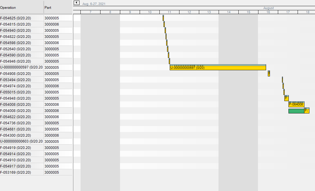

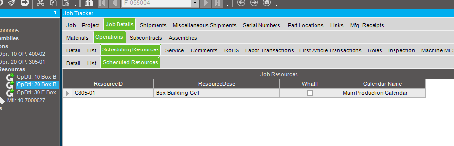

Working on scheduling and was told / believed that I could get all the information that I needed from the ResourceTimeUsed table. Unfortunately, even after removing What-If jobs, I still find my employees with multiple jobs scheduled at the same time. If I then check the resource scheduling board, most overlapping jobs have disappeared and if I drill down to the individual operations, the times listed on the scheduling board are different than those that appear in the ResourceTimeUsed table. If I use the field help, the values on the Resource Scheduling Board come from JobDetail, a table that I cannot access via Query so I’m assuming it’s built when the Resource Scheduling Board is called upon. Any idea where I can get this information or how to determine the way it is building this data. I tried a trace, but it gave me very little that I was personally able to work with.
