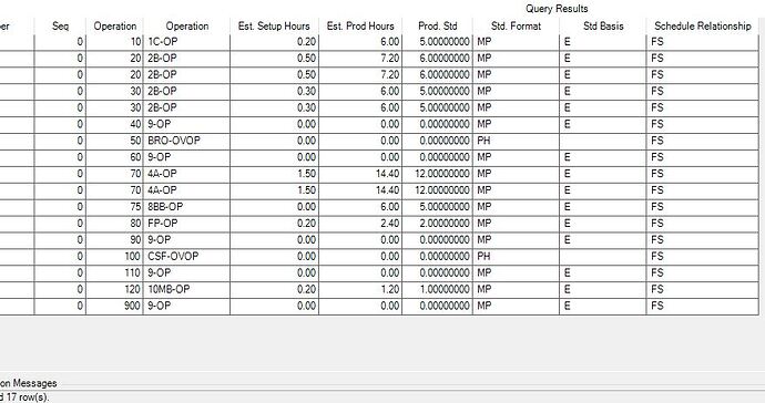

I tried the obvious things from that thread like looking for operations with weird Prod Stds, or missing Scheduling factors (finish-to-start, etc). The job looks ok. If I schedule it without finite resources checked, it works ok. If I take the due date and push it out a year, it schedules ok even with finite resources checked. We didn’t have any updates or changes to our system since it was working fine yesterday. We don’t have any methods firing off of this form as far as I can tell. No new customizations have been made to the form recently. It happens on my pc and other’s pcs.
