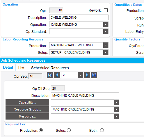

We had an issue like this back in 10.2.200.3 during upgrade testing. I created an Epicor Case(CS0000949039) for it.
This is how I explained it to support:
Create a Job with two operations:
Opr 10: Start-To-Start, Labor Reporting Resource for Production: OprDtl 20, Labor Reporting Resource for Setup: OprDtl 20
-OprDtl 10: Labor Resource Group Marked with “Use Calendar for Queue Time”
-OprDtl 20: Location Resource Group Marked with “Use Calendar for Queue Time”
Opr 20: Finish-To-Start, Labor Reporting Resource for Production: OprDtl 20, Labor Reporting Resource for Setup: OprDtl 30
-OprDtl 20: Production Location Resource Group Marked with “Use Calendar for Queue Time”
–Marked for Production in “Required For” on Scheduling Resource Detail
-OprDtl 30: Setup Location Resource Group Marked with “Use Calendar for Queue Time”
–Marked for Setup in “Required For” on Scheduling Resource Detail
Backward Schedule from Current Date or Forward Schedule with any Date will throw the exception.
For us it was caused where on a Operation the Primary Labor Resource Group for Setup is different than the Primary Labor Resource Group for Production and using the “Use Calendar for Queue Time” on the Resource Group.
Unchecking all the “Use Calendar for Queue Time” on the resources was a workaround.
The ticket was closed with SCR ERPS-88458 and fixed at patch level 10.2.200.7.
