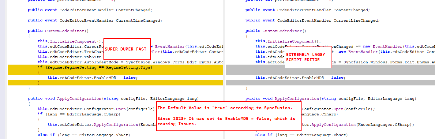

All of those 3 have been Updated, I am not sure if Syncfusion is throwing some Event or they fixed a bug of theirs, so now Epicor is being flooded with LineChanged events or something.
In 2022.2 it stays on InitializeCustomCode or so, but in 2023.2 it loops through every line and the dropdown changes its value many times… The more methods, the slower it is… I mean changing one with 25 methods and you will fall into Not Responding.
Its sluggish in general too. Works fine in 2022.2 and I dont have 2023.1 right now to test.

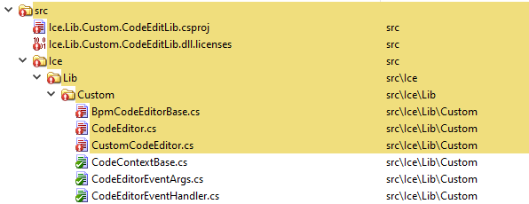

The Issue exists in Ice.Lib.Custom.CodeEditLib.dll in the following classes CodeEditor, BpmCodeEditorBase and CustomCodeEditor in all of their respective constructors.
By default SyncFusion sets EnableMD5 = true and in 2022 and prior there was an if statement to check for FIPS, and if FIPS existed it was set to false. That if statement was removed, so now its always being set to false.
Fix
Comment out the EnableMD5 line, or leave EnableMD5 as true. Now the Editors open up like 10x faster and Clipboard operations work fast.

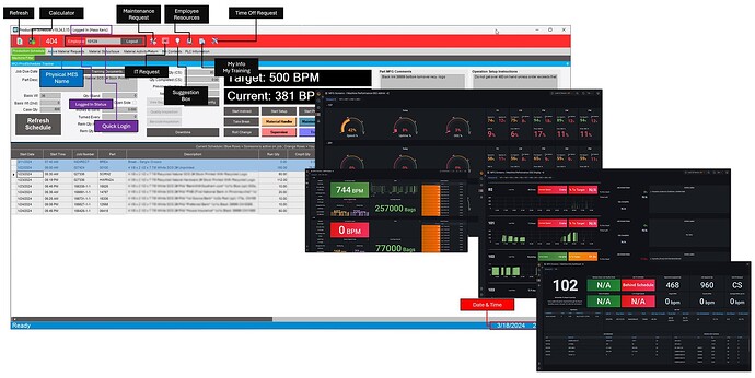

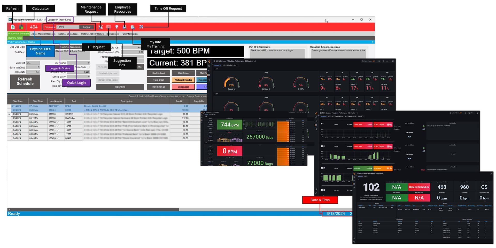

I dont think Epicor has given up on classic yet, they are still changing stuff and adding stuff such as a Helper to Track stuff. Many of us plan to be on Classic for a while, I think Josh and I are going to be on several forms on Classic until the very end. It works for us.
Our MES Replacement with OEE Realtime Data, Paging Buttons etc… Made it simple and large for Operators use it. Josh killed it on this one, then I just made it more dummy proof
