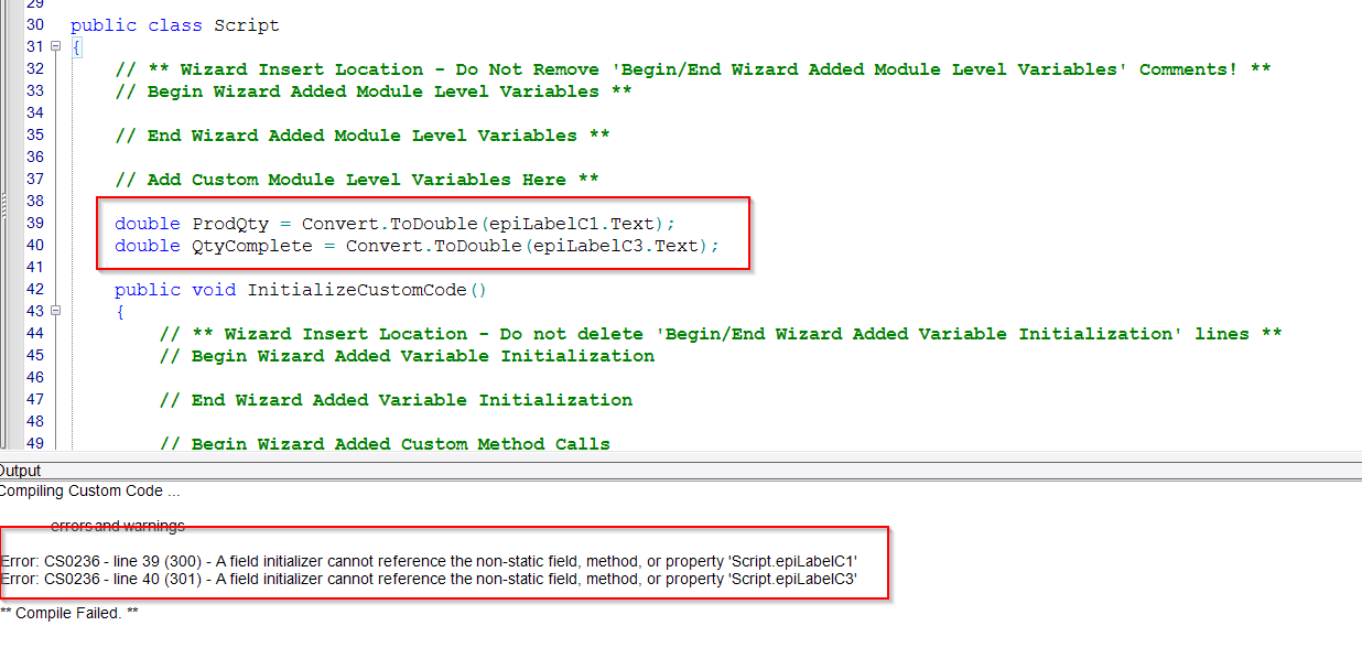

In the “Start Production Activity” for MES, I would like to add additional fields for informational requirement from my users. I did a foreign key link to JobOper to get the ProductionQty and QtyCompleted. I had both of these displayed in the textbox. My user asked if I can take these 2 texbox and calculate the difference to tell them the remaining balance for each operation.
I thought since the 2 textboxes are strings, i convert them into double and then do the math. However, when I did that I get the following error.
Any ideas how I can take these 2 textboxes and do calculation?

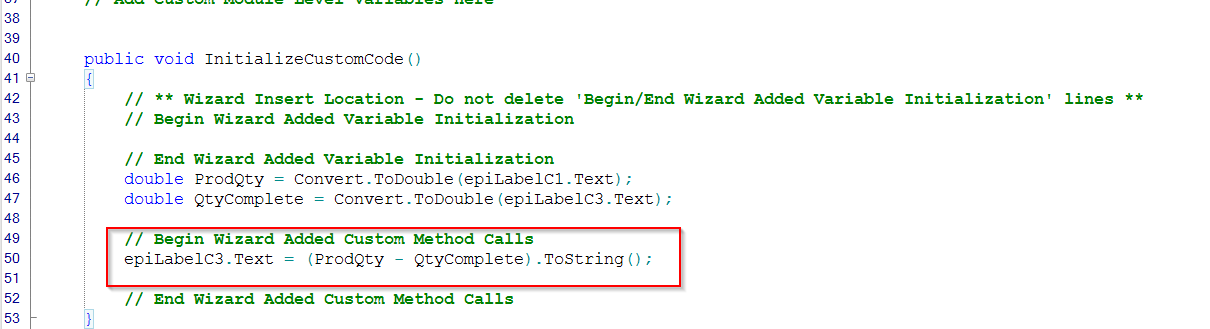

Never mind. I caught where I placed the variable. I moved it down to InitializeCustomcode and it’s fine now.
