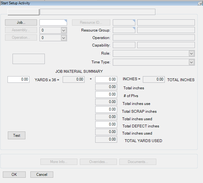

We added some custom columns to the JobOper table. We would like to save this data from the MES Start Setup Activity form. We were able to bind the fields to the JobOper table but then realized that it is read-only using the foreign key view. I have been trying some C# code to update these columns but have come up short. Any idea’s on how we can save this data back to the JobOper table from the Start Setup Activity?

Here is the calculator that I am trying to save a few pieces of data from. I currently have an updatable BAQ that will update the values I want. I was able to call the BAQ using the button and see the values I want to update. Is there a way to update those values using that same dynamic query call with updatable BAQ from the button?

After combining pieces of code I found on the internet, the code below is saving the calculator values back to the JobOper table using an updatable BAQ.
