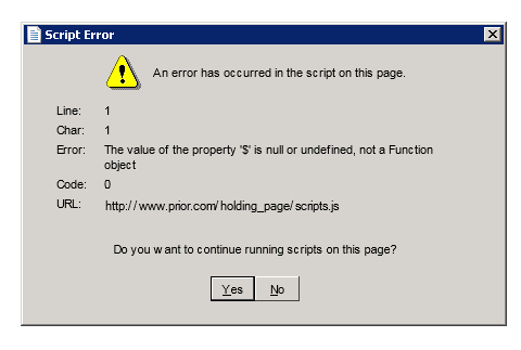

When opening epicor as a specific user i get the below 3 script errors
I’m able to continue as normal once i either Yes or No.
Has anybody seen this before and what could be causing the problem?
Many thanks in advance.
Epicor 9.05.701
Web Tab under Options --> Preferences. The integrated web browser in Epicor doesn’t always handle javascript correctly.
Looks like a webpage that somebody has added as a Menu Tab, which is being loaded each time. www.prior.comhttp://www.prior.com mean anything?
Thanks guys…i didn’t notice, your absolutely correct.
