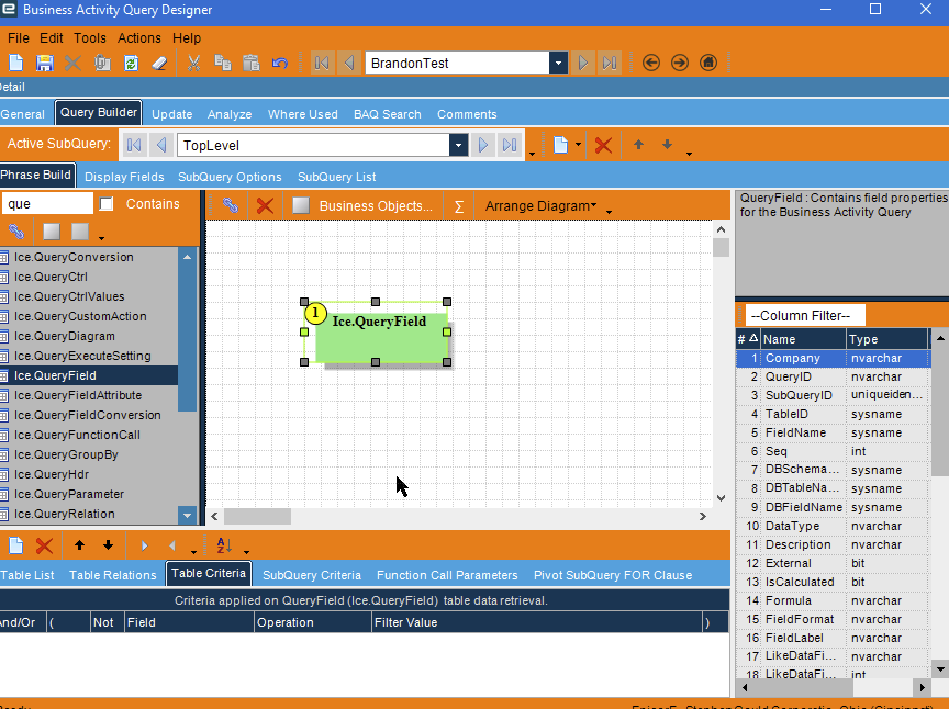

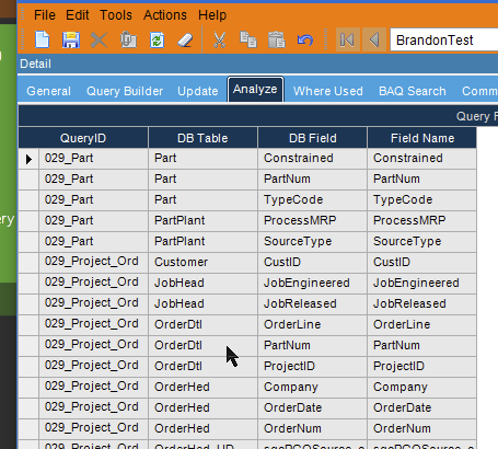

You can query the queries. This table (ice.QueryField) has the field info. Filter for your field and you get a “where used”
Bravo sir! Thank you!!

Sorry to open an old thread here but how can you tell what type of query it is? Like if I wanted to pull all SSRS reports and BAQs that use a specific field, I can set up this BAQ but how do you determine what each query type is?
This is only going to get you BAQs. Some of which might be used in SSRS reports, but not all SSRS reports use BAQs.
And knowing where a BAQ is used is harder. (I’m assuming that’s what you mean by type?)
