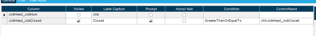

Could you just add a boolean calculated field in the BAQ based on if it is blank and then when searching for the blanks just search based on that being true?
That was a nice thought and I was eager to run with it… but it really needs to be if checked, show me blanks, if unchecked show me blanks and nonblanks.
So make your prompt greater than or equal to rather than equal to.
Booleans are treated as 0 and 1.
Greater than or equal to means unchecked shows both true and untrue. Checked only shows true
You’re the best! This is so simple and effective.
