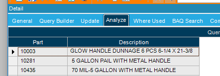

Hello Everyone,
Is there a way to have do a search a field as a selection? I tried the following below:
But it errored out.
If anyone has a way to accomplish this, I would appreciate your assistance.

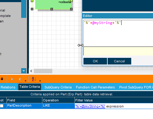

Use like, then an expression, add the % around the parameter.

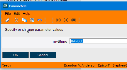

use Compare Operator of MATCHES with the parameter
When you test and the parameter comes up use * as wildcards in the beginning and/or end of the string.
I am trying to create a user prompt so they can look for information within the text box. An example would be specification.
Thanks in advance.
Miguel
