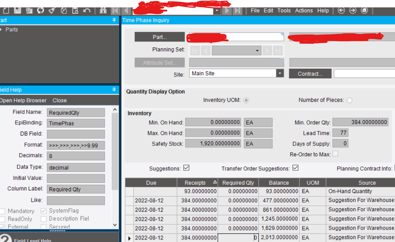

Is it possible to make a BAQ that can inquire the Time Phased Inquiry of all parts at once?
Currently, Epicor’s Time Phased Inquiry must be inquired for each part. So I was trying to make a BAQ where I could see all the parts at once.
I want to make something like the example below. But there is no DB Field for that field, so I don’t know how to create it. I sincerely ask for your help.

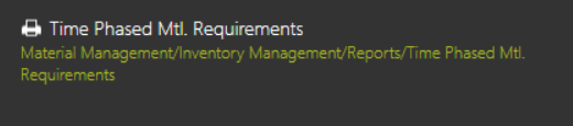

There is Time Phase in Epicor which your screen shot shows but also Time Phased Material Report. This allows you to run open i.e. no filter and can be output to CSV:
I am not sure of your BAQ skills but I am definitely having a look at @JasonMcD BAQ as well.

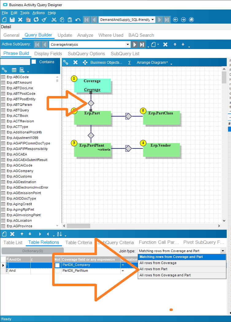

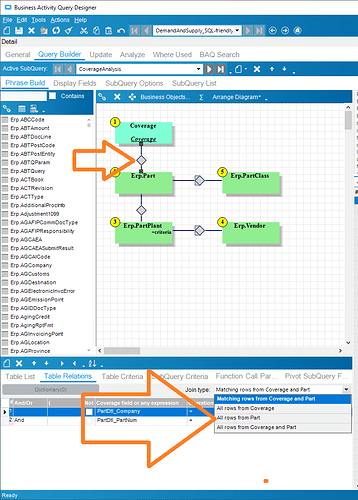

You need to change the join. I think it would be a “right inner join” in SQL parlance, but at some point in (10.2.x, I think) Epicor changed the wording of this dropdown to plain English.
For extra credit, I personally like to change the order of the tables where 1 is the main thing (Part in this case). I have no idea if that matters or not.

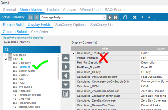

Also, you need to change the part number field. I apparently grabbed it from PartDtl, but since you want all parts, you’ll need to grab it from the Part table.
Sorry to keep bothering you. Thanks to your advice, I made all the parts appear.
