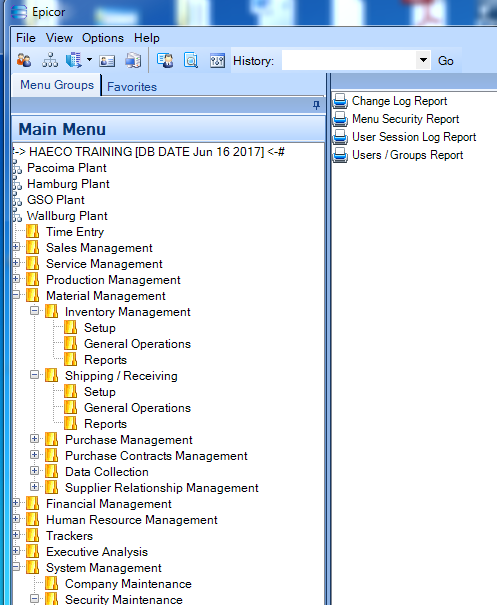

Yes, under System Management>Security Maintenance > Reports >User/Groups Report

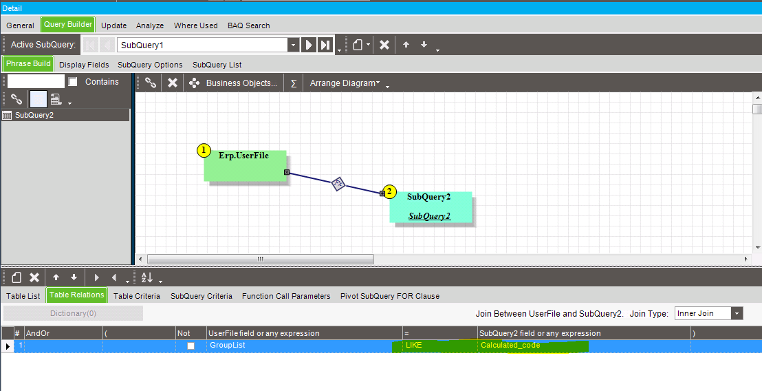

I think I have a solution. Which I can’t believe actually works
Make a BAQ with a amain Query and 1 sub Query
The Main is
The secondary is just the table SecGroup, with the following fields
The calulated field named ‘code’ is just
This works by making the SecGroupCode have the ‘%’ in the front and back, and then linking the tables with the LIKE operator.
Set the link in the main query to Left Join to include all the users with no SecGroup Set
One caveat. You get bad results if one secID is entirely in another.
For example, having secGroupID’s ‘SEC1’ and ‘SEC10’
I have a solution for that, I’ll post later
The fix is to have the sub query return 3 calculated fields
code1 = SecGroupID + ‘~%’
code2 = ‘%~’ + SecGroupID + ‘~%’
code3 = ‘%~’ + SecGroupID
Then have 4 link parameters
UserFile.GroupList LIKE query2_code1
OR UserFile.GroupList LIKE query2_code2
OR UserFile.GroupList LIKE query2_code3
OR UserFile.GroupList = query2_SecGroupID
This allows to it to match the exact groupID if its the first, middle, last, or only member of the group lisy
