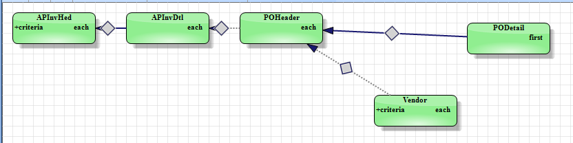

I created a BAQ but the query doesn’t like to use the Vendor ID. If I change to use Vendor Num then it works. The issue is the Vendor Maintenance and Tracker screens only display the Vendor ID.
Below is my layout.

Hello Dan,
I have the dashboard that only pulls invoices that I have a Purchase Order, but I need to display invoices that do not have a purchase order as well. How to I get both to appear?

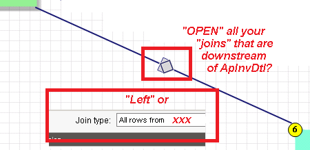

From your screenshot - looks like you just need to “open” all the joins downstream of the ApInvDtl table.
e,g, change them to “left” or “All rows from…”
Progress or SQL doesnt matter. Epicor uses VendorNum to join the tables

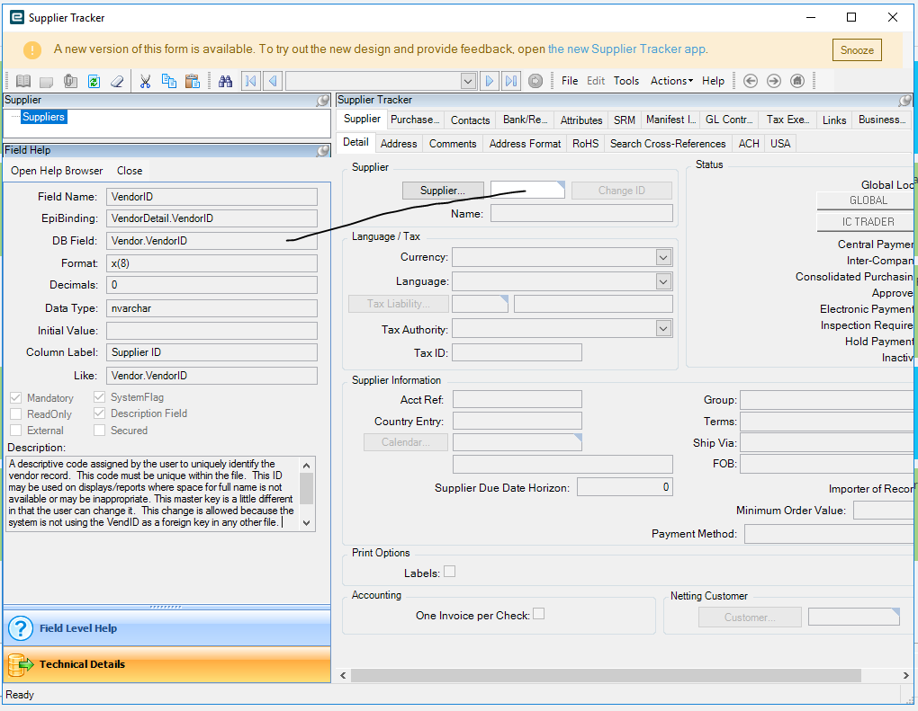

You should have access to the Data Dictionary. The descriptions to the fields are in Italics
VendorNum is an Int
A unique integer assigned by the system to new vendors by the maintenance program. This field is used as the foreign key to identify the vendor in other files such as CheckHed, or POHeader. The end user should never need to know about the value of this field.
VendorID is a nvarChar
A descriptive code assigned by the user to uniquely identify the vendor record. This code must be unique within the file. This ID may be used on displays/reports where space for full name is not available or may be inappropriate. This master key is a little different in that the user can change it. This change is allowed because the system is not using the VendID as a foreign key in any other file. Instead it uses an internal value, VendNum, which cannot be changed, and is assigned by the system, for linking other records to the Vendor.
I hope this clears up the original question.

Thank you Bruce, it works as expected now.
