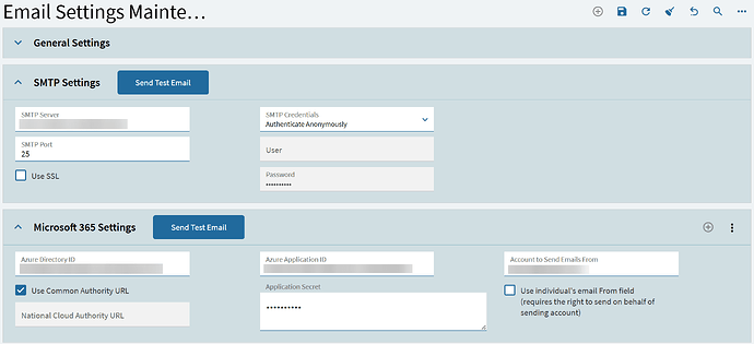

I am wanting to change our emails from SMTP to Microsoft 365. I have set up the M365 Email Settings successfully, but any functions using GetMailer/ISmtpMailer are still sending via SMTP.

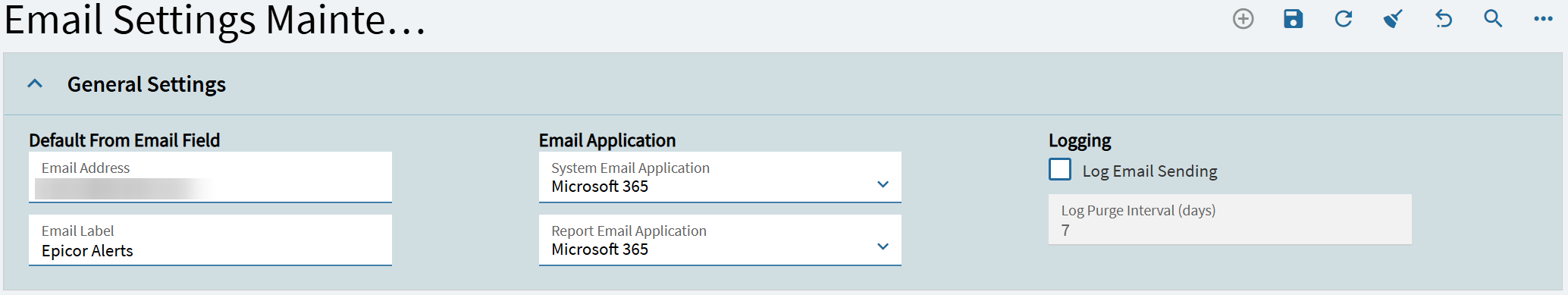

In Email Settings Maintenance you can set up the system to use Microsoft 365 mail directly via App Registration, not using SMTP. I don’t know of a way, in code, to take advantage of this form of email delivery. Epicor is doing it somehow, I’d like to do it in my Functions as well.

Did you remove the smtp settings when you set up the other?
I’m not certain, but I think that class actually just uses the default mailer.
yes, it uses mailer selected for System/BPM in Email settings show above
Yup the GetMailer ISMTP Mailer works fine.
I set the defaults at the top to M365.
I just set up m365 mail in mine.
I changed the smtp server to a bs value so it wouldn’t work.
Ran an email in a function with getmailer.
I got it. It had to come from msgraph.
Thank you everyone! My mistake.. I was under the impression that the Email Settings were applied system-wide, not per-company.
My function was running under a different company than the one I configured for email via Microsoft 365 Graph.
Once I configured the other companies, it is working as expected.
