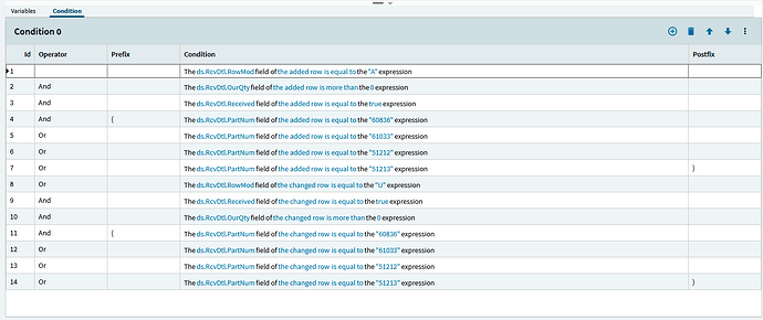

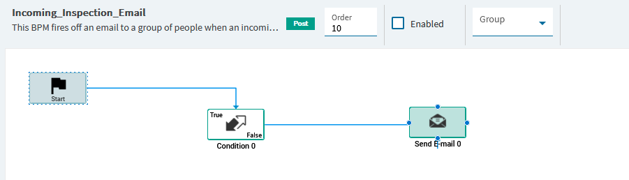

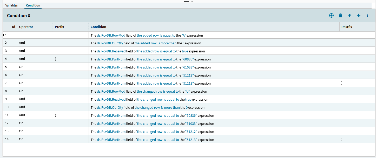

This should be fairly simple.. There are 4 parts that require incoming inspection. I want an email to fire off ONLY when these parts are received to inspection. Above are screenshots showing one of the BPM’s I tried.

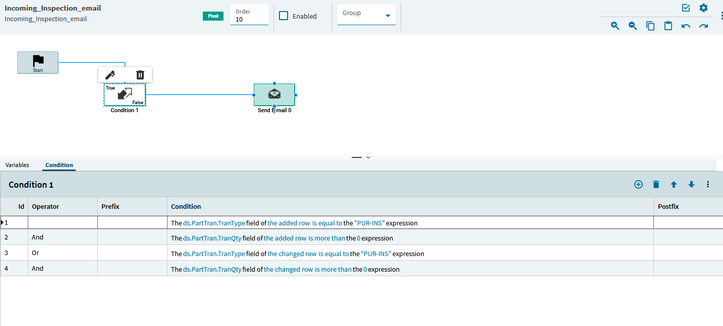

Below is the PartTran.Update BPM I also made and tried.
Additionally I tried doing this on parttran.update as a post processing method directive… The transaction is PUR-INS, purchase to inspection.
I get emails - the emails have absolutely nothing to do with the parts I’m specifying or the transaction I’m trying to be notified of. Instead I either don’t get an email, or I get an email for some other random receipt.
Can someone help me out? What am I doing wrong or am I retarded for thinking I could send a simple email as the result of a very specific transaction?

Thanks for the response I will definitely try that… That being said… I look at the condition node on the canvas and see a true side and a false side. Does that have any relevance or bearing on BPM’s anymore or is that no longer relevant? Am I simply joined on the wrong true/false output?
