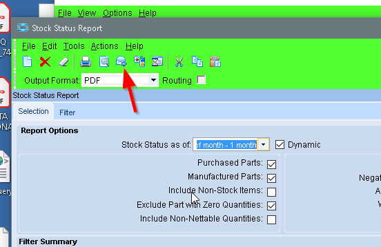

Do a test where you print some report, but use the email option:
Then fill in the SSRS Email / Fax dialog
Note that hitting the Enter key while in any field, is the same as clicking the OK button.
If you don’t receive the email, then check the system monitor.
The email icon at the top of the print window is not active, therefore I cannot select it.
This indicates something is not properly configured within our E10 environment.
Where would I look from here?
Sorry, just noticed we have a customized non-SSRS report defaulting for the Stock Status report. Changed the report to the base SSRS report and the email icon activated.
