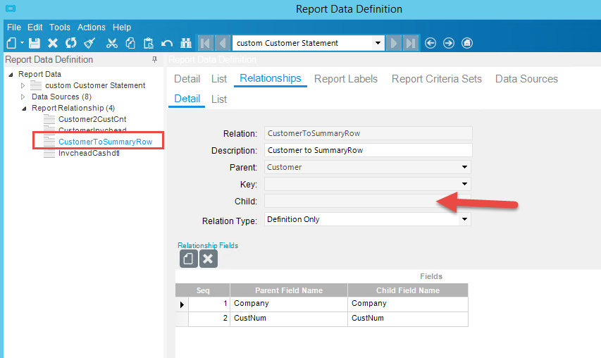

Hello, it’s been a while, but I experienced this same issue and have since drawn a conclusion on what causes this.
Usually, this happens because UDCodes is present in a report relationship on the RDD but is missing from the table list in the RDD. The UDCodes table is likely missing in the RDD in Epicor 10 due to the fact that UDCodes is now a part of the Ice schema.
As a precaution, I delete and re-add all tables and relationships that refer to Ice.
A customer of mine had the same issue with the Customer Statements report after upgrading the epicor version from 10.2.100 to 10.2.400, in case you get the same message (Sequence contains no matching element), it is related to a missing table in one of the relationships. The way to fix it is by removing the relationship with the missing table (it usually has the Child table in blank) or if you have an environment with the previous version review the standard RDD to verify what the original tables and relationships are.

I’ve now encountered this error in doing our conversion from 10.1.400 to 10.2.400
The system data definition for the Customer Statement in 10.1 contains a reference to a AUNZ table. This table doesnt exist in 10.2. I assume it is meant to be part of a CSF?
Our Customer statement used a fork of the 10.1 definition which once in the converted 10.2 db refers to a table that doesnt exist! And raises this exception.
We use SSRS not crystal, but definitions are common to both report styles.
Yep, got the same error on an upgrade to 10.2.500
Found this wonderful tidbit and made the change (removed the relationship to AUNZ…)
also had to Un-Exclude a couple of fields in the InvcHead (TaxRegioCode and OurBank ) which are used in other relationship keys.
not sure why, but it works
thanks to all the previous posting user for their help.
