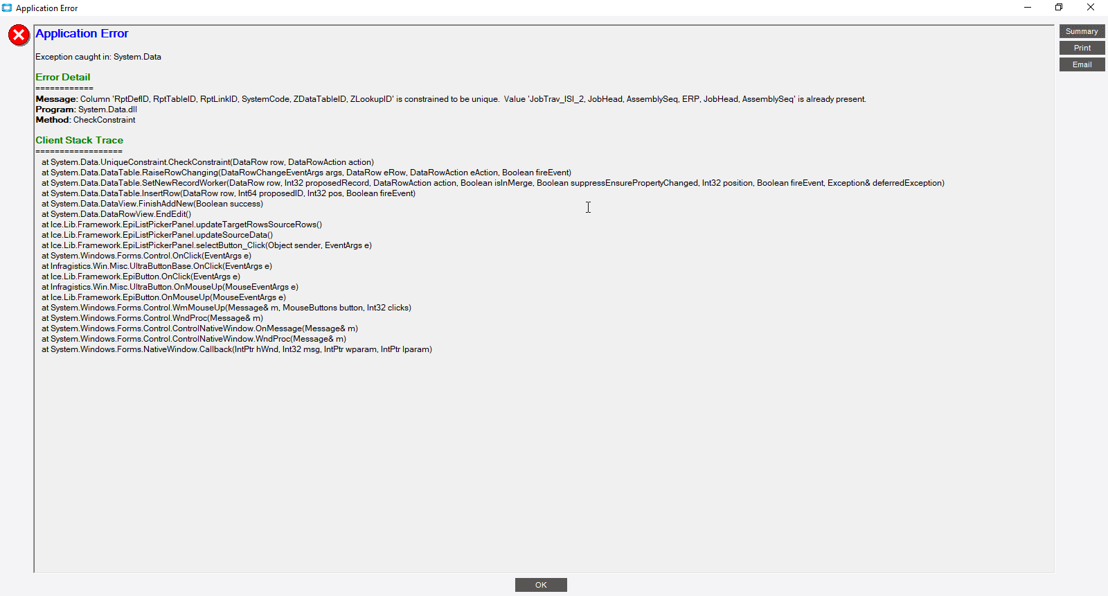

Doh! Turns out I ran the wrong report style after rebuilding the RDD.
That part actually worked and it makes it to Crystal. Now the issue I’m running into is the Crystal report cannot find the any of the Linked fields such as JobAsmbl.JobNum_ProjectID.
When I add the line manually the the XML, it likes it.
It seems that the RDD isn’t writing the linked fields to the XML file.
I tried deleting them and re-adding them, but that didn’t seem to work. (Yes, I previewed the correct style this time!)

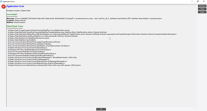

Just for grins, I added all pick link references and it gave me this nice lovely error.
Once I hit okay, selected the original links, then refreshed the RDD, it showed me that the JobNum_ProjectID link truly wasn’t there and it finally let me add it. I have to do that error process every time I want to fix the linked fields on other tables. What is going on??
