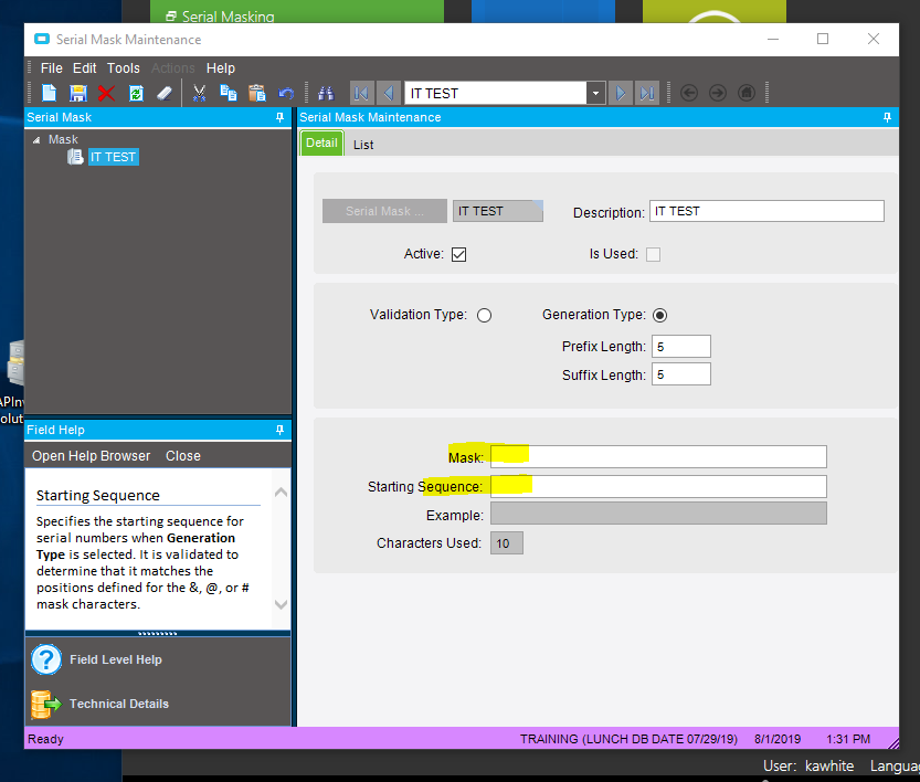

I am setting up a new serial mask and I am using generation type, have a prefix/Suffix length set…It wants me to enter something for MASK but I have no idea what it is suppose to be. I have tried everything and the user guide and help file is very vague. I know I am missing a step for serial masking but I can’t find the screen.
thanks

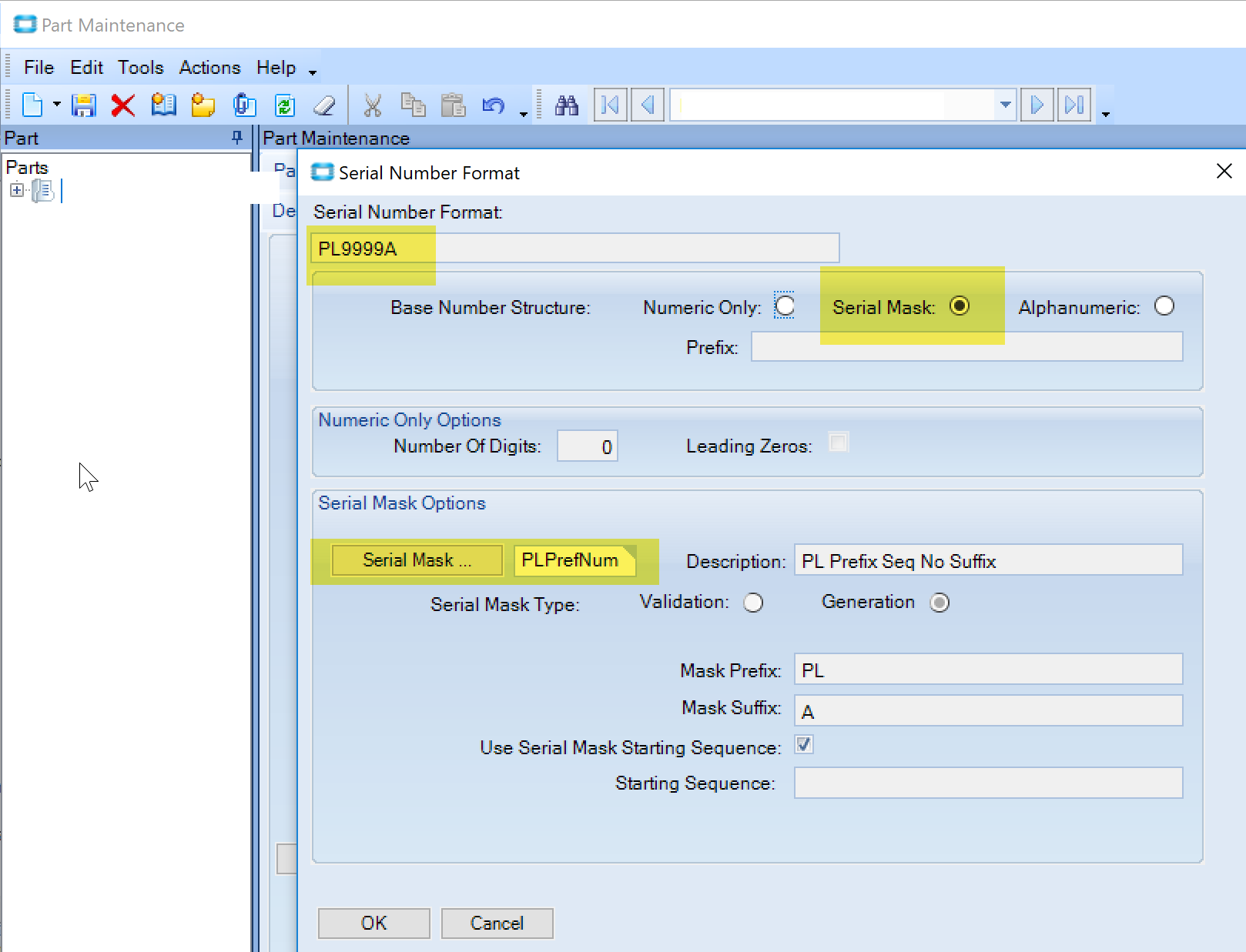

Hi Kimberley,
The Mask can be the number of sequential digits to use. See my example below with 4 digits used. We started at 1 but are up to 1122 on this particular serial number.
And here’s a “PL” mask of ours assigned to a part:
Nancy
