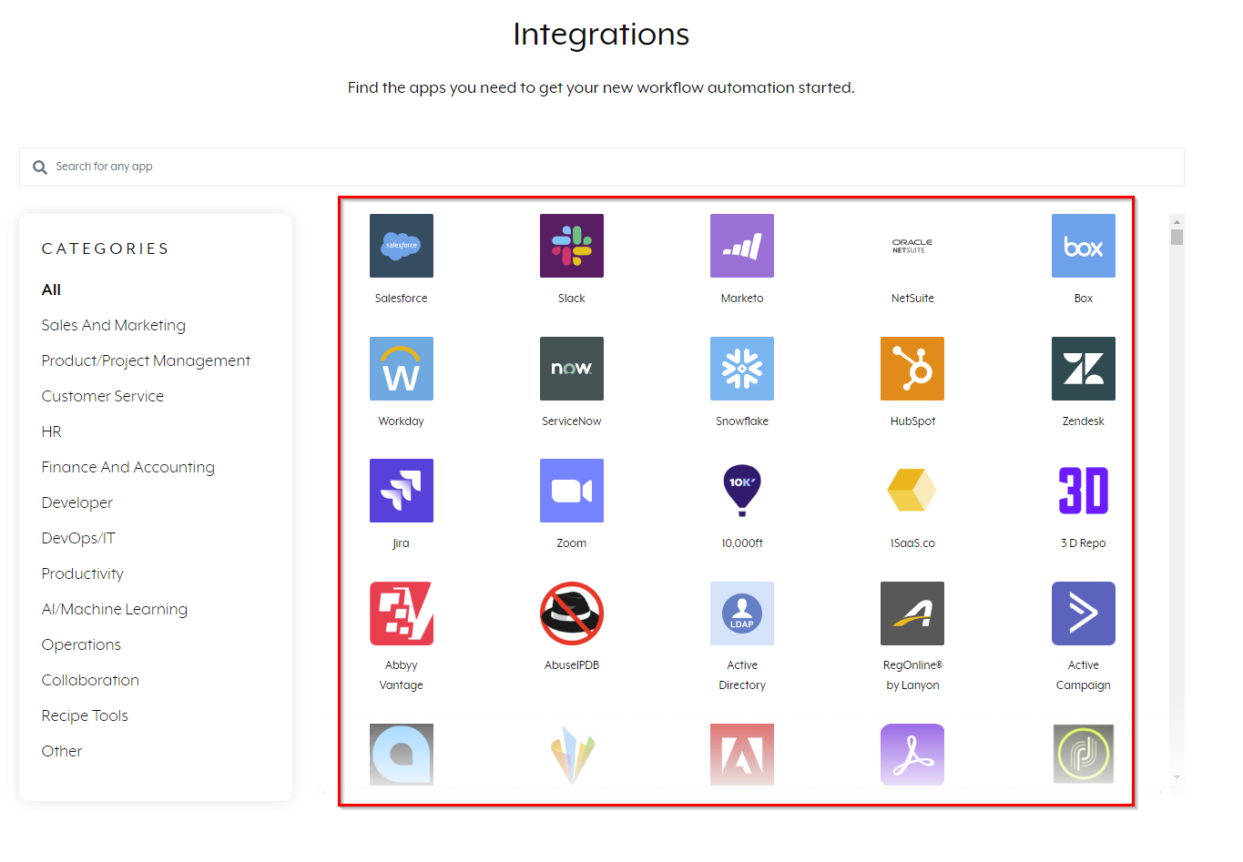

A Connector to a system. System is the operative word.
Epicor → Production +250
Sales Force → +250
etc.
Each one of these is a connector. You can run unlimited integrations per connector, but each is $250/mo per active Connection
correction
Okay that didn’t come across as clear as it could have been. you can use Any connector you’d like but they charge per Connection that is an Active connector that is connected to an endpoint
So let’s try again
Epicor (is a connector)
Sales force (is a connector)
Those connectors by themselves don’t cost anything extra. But when you make a recipe and you connect your Epicor connector to your “Test” system that counts as 1 connection (+$250)
Then when you connect your Sales Force Connector to your Sales Force Instance that counts as 1 Connection (+250)
So an integration between Epicor and Sales force will run you 250+250 for the LIVE Production Recipe
The test environment you can play at and as far as I know they do’nt charge per connection there they just limit the transactions to test transactions.
Hopefully that makes things more clear.
