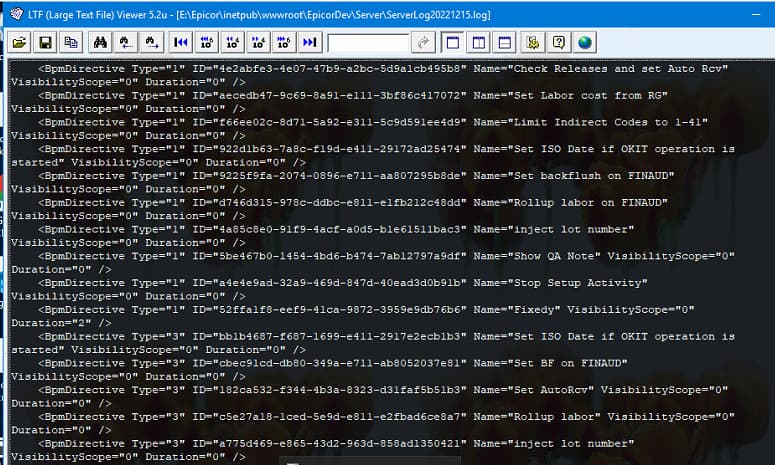

Yes, @Mark_Wonsil for debugging and tracing this into nice neat rows dumping all of the print requests would be awesome. Below is just from my start activity and without any write events.

Ok, I finally found my ServerLog.
It only has one entry in it. (An error I had on the 23 of Dec) So I don’t really have a lot to work with.
I need some schooling on how to get more entries in it, and maybe some sample data.

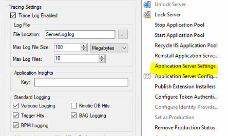

@klincecum Probably Verbose would be enough. These are what I have set. Yes, I log a lot ![]()

I’m a cloud customer, I don’t have access to that. I need something that puts traces in with
whatever is default. I only have the client side trace settings.
