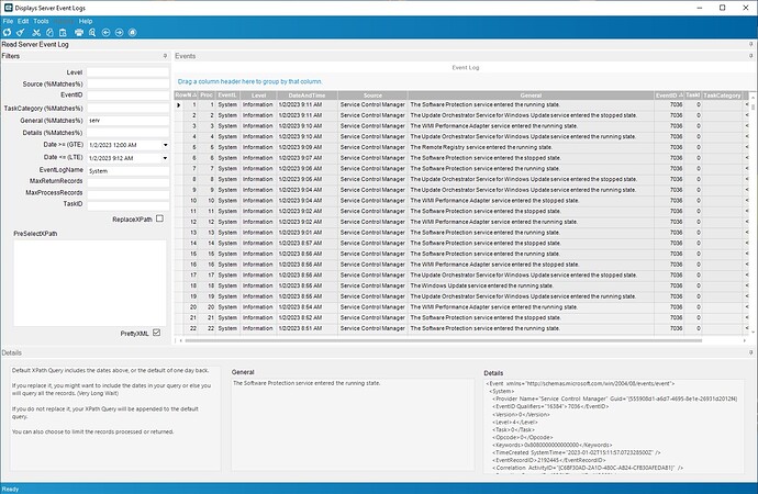

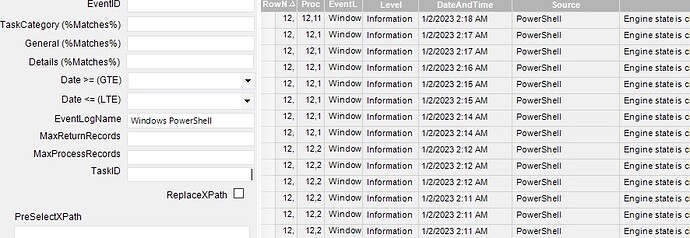

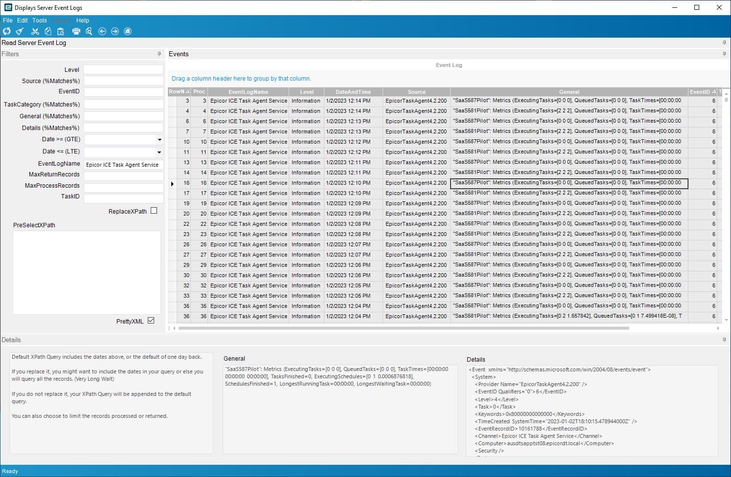

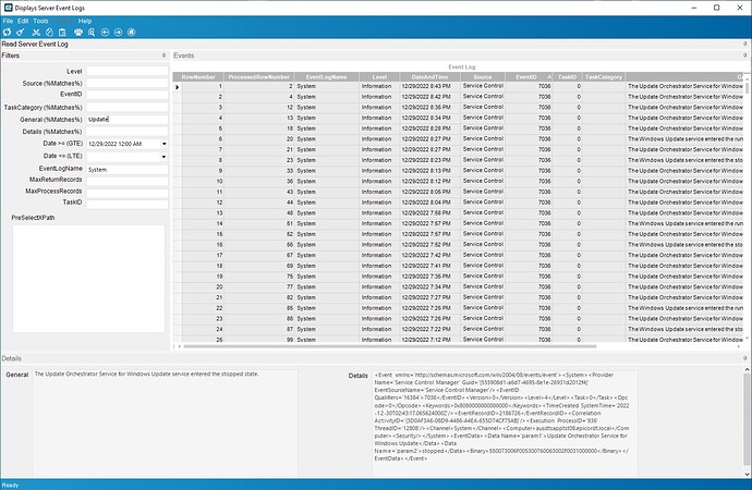

So, I did a thing. Got to do a little bit of touch up, and I’ll share it with the community.
Here is a screenshot.
ooo… :eyes:
I didn’t know I’d ever get excited over logs
I’m not sure how best to share it, so I’m going to do a write up and attach the files.

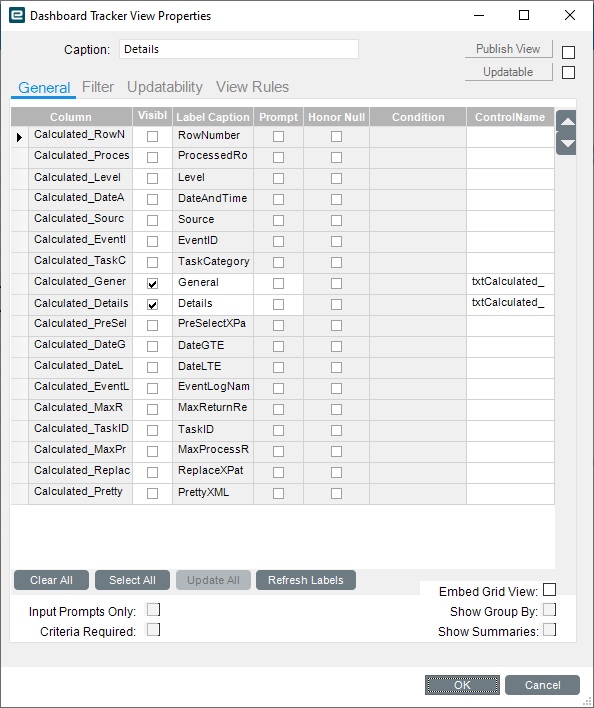

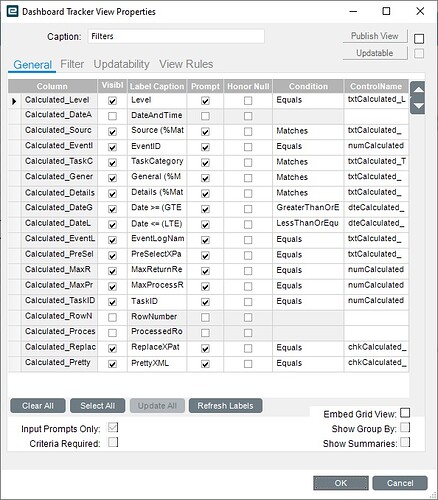

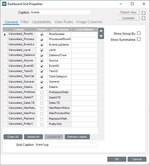

Here is the BAQ Portion
Create the below Calculated Fields in the BAQ.
Set the BAQ to Updatable, Advanced BPM Update Only.

Your BAQ should be complete.
Now, on to the dashboard
I have the main grid, a filter section, and a section to display the details

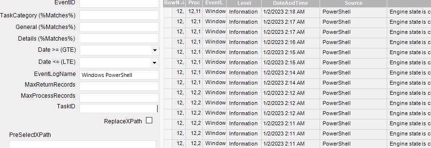

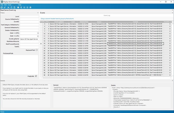

Here are three pictures showing how I set up the dashboard:
I then customized the deployed dashboard to look like the following:
The following code is for the script section. If you are recreating this manually, you

Ok, some notes:
You can really only see Application, and System Event Logs.
Setup is blank, and Security is locked out because you won’t have permissions in our context.
System is default. If you leave EventLogName blank, it will query System.
MaxReturnRecords is the maximum amount of records you wish to return.
MaxProcessRecords is the maximum amount of records you wish to look at in aggregate.
Example, I want to look at the last 10,000 records to see if they match a certain criteria, but I only
want a sample size of 10 records back. You would set MaxProcessRecords to 10,000 & MaxReturnRecords to 10.
Use them if you want.
Date >= (GTE) & Date <= (LTE) fields are included in the XPath pre-select query. They will filter the records
before processing to only records in that range.
The default range is less than Now, and back 1 day.
The PreSelectXPath field is in case you want to write your own XPath queries. (XML filters based on the XML Details)
The ReplaceXPath checkbox is there in case you want to disregard the default XPath query and completely roll your own.
The default is to not Replace, but Append your XPath query onto the default (it’s literally an “and”).
The default is to query between the dates set above, or the default of back one day.
If you do a replace, it might be good to set date filters or max records filters, because Epicor is storing 3-4 months
of records. If no filters, prepare for a looooooooong wait…

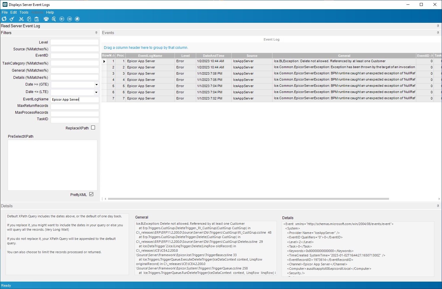

@klincecum @MikeGross On my app servers these are the paths for the App Server and Task Agent.
What is the “Full Name:” in the properties?
The name above the path. Epicor ICE Task Agent Service or Epicor App Server.
@klincecum I got excited when I saw the name that you were digesting the ServerLog Trace Logs from the app server. Those are a beast to wade thru all of the print requests to get just the bpm calls and errors. I am going to look at possibly adapting this to do that.
