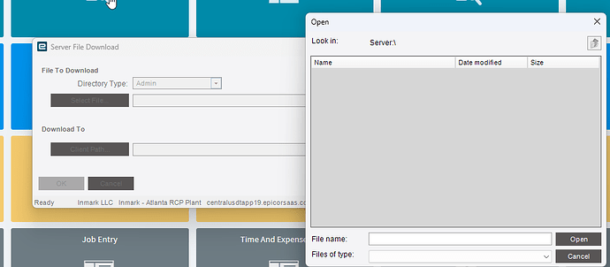

Thanks @Rich, do we have to request the logs be turned on, or will they be on by default?

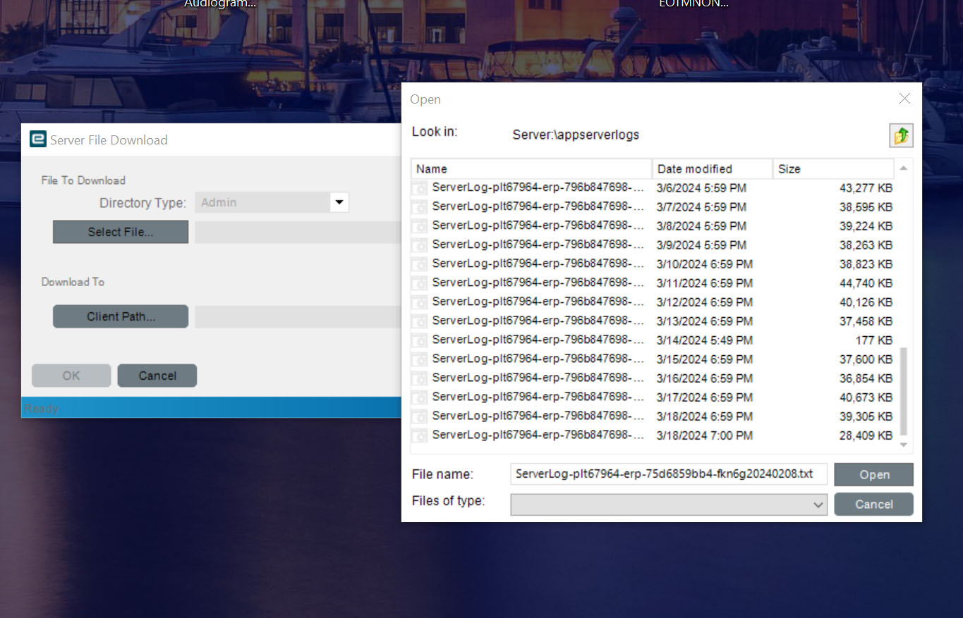

Once a day?
I just downloaded the last dated one twice and verified, the last one is live data.
Time is Zulu time.
Modified time is when it was closed for the not live ones, and when it was started for the last (live one).
So we are all good! ![]()
Yes, we have it enabled in Pilot and Live.

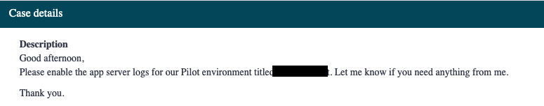

How did you get it? I asked through support and was told its not possible so I didn’t ask the right person or use the right words . . .
This was my original request. I eventually had to get the case transferred to Tier 2 because what Tier 1 did didn’t work. Bradley Johnson got it done.
It worked!!!
