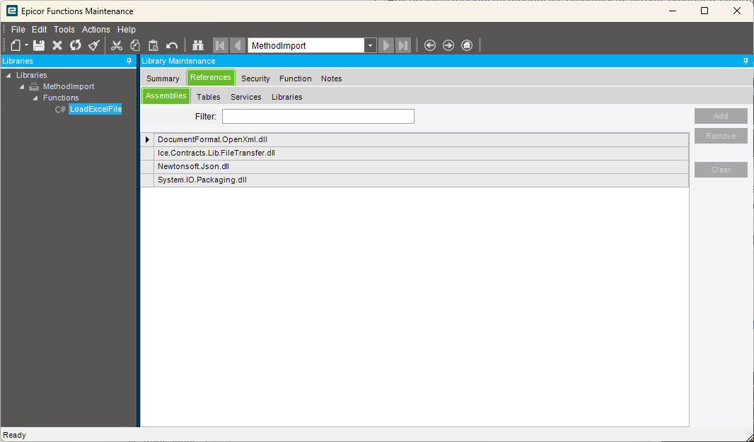

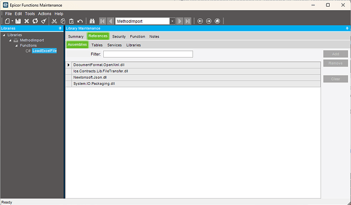

I was able to read the sheet names using the ExcelReader, but I think I will switch over to the byte array and use DocumentFormat.OpenXml. Using the service to read the file seems much less likely to break than
F:\EpicorData\{TenantID}\{TenantID}\Companies\{CurrentComany}\{Folder}\{File}

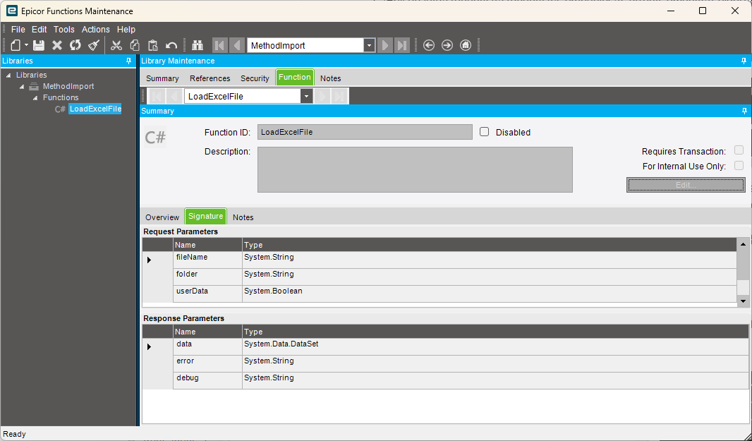

Thanks for everyone’s help. I successfully created function that reads an excel file that was uploaded to the server and returns the contents in a data set. This works in the cloud.

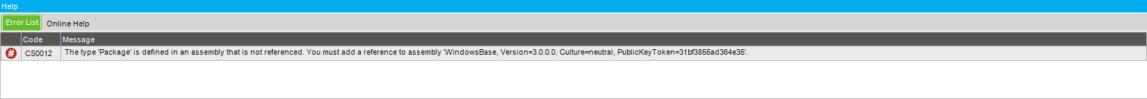

The code editor does throw an error, but if you ignore it everything works.
