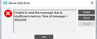

Anyone here faced this error before: "Unable to read the message due to insufficient memory. Size of message = 3004246"
Happen when tried to save Order Entry (customization screen).
I use the clear button at the toolbar to clear the cache. But it did not help.
2019-04-15_9-24-28
Please advice. Thanks
It would be helpful to see the full stack trace from the “detail” button.
Hi, what size is the order?
Apparently 3GB big bahaha :grimacing:
I took that number to be the size of the error message
EDIT: and it’s only 3 MB, not 3 GB :wink:

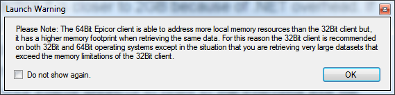

@Bart_Elia this happens if you run a BAQ with about 500K rows (Which is small potatoes for a mfg plant nowadays). Just wondering if you guys have any plans to phase out the 32-bit and make the 64-bit the default?
Obviously we can change it. But the Warning makes it feel like “dont do it!!” lol
I think the 32-bit should have a warning too saying “dont use this, use 64-bit unless you sell Lemonade only” :slight_smile: #LemonadeStand
At least you can suppress this warning for your users if you are so inclined :slight_smile:

that doesnt sound good at all. BAQ? Dashboard? or SO Entry? if its SO Entry, does it happen in BASE - Perhaps you have a Customization that runs a BAQ or a BO and tries to pull in too much data?
Hi,
Could you please show the [Detail] of the error? Or even better, go and look at the Server Windows Event Logs when you get the error, and look at the Server exception details. That could give us an idea of what is throwing the exception.
It’s also relevant to know info about the environment you are getting this error from.
Is the client running on the Epicor Server or on a client workstation/pc?
Is Epicor App Server and DB server on a single server?
Are more than 1 user running Epicor client(s) simultaneously when the error occur?
Other users, using their own client, on separate computer, are able to replicate the error?

Server Side Error indicates that the error is coming from the server and hence you need to look at the DETAIL of the exception and try to figure it out what is causing it. My guess is that there is a BPM with an (infinite) loop that gets aborted by the server after N iterations, or that it is doing IO and loading large file(s) into memory, or the UI has a customization with an embedded Dashboard or too much data loaded into UI control (ultragrid), maybe with an unfiltered BAQ.

Maybe the reason behind the Epicor.exe 32 bit client by default is restricted memory allocation per client, specially if all users run Epicor client from a single server (via RDP/Citrix).
If you run the client on your own personal computer, then it may make sense to use the Epicor64.exe but only if you get System.OutOfMemoryException.
Regards,
@carlosqt Agreed. I was thinking maybe because of thin clients, ARM, Tablets etc…
