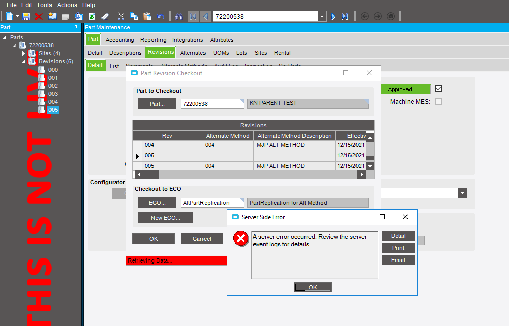

Server Side Exception at CheckOut the Revision
Getting the below error when CheckOut the Revision with Alt Method. Can you please let me know
how to fix the issue.

Client Stack Trace
at Epicor.ServiceModel.Channels.ImplBase1.ShouldRethrowNonRetryableException(Exception ex, DataSet[] dataSets) at Erp.Proxy.BO.EngWorkBenchImpl.CheckOut(String ipGroupID, String ipPartNum, String ipRevisionNum, String ipAltMethod, Nullable1 ipAsOfDate, Boolean ipCompleteTree, Boolean ipValidPassword, Boolean ipReturn, Boolean ipGetDatasetForTree, Boolean ipUseMethodForParts, String& opCheckedOutRevisionNum, String& altMethodMsg, Boolean& altMethodFlg)
at Erp.Adapters.EngWorkBenchAdapter.CheckOut(String ipGroupID, String ipPartNum, String ipRevisionNum, String ipAltMethod, DateTime ipAsOfDate, Boolean ipCompleteTree, Boolean ipValidPassword, Boolean ipReturn, Boolean ipGetDatasetForTree, Boolean ipUseMethodForParts, String& opCheckedOutRevisionNum, String& altMethodMsg, Boolean& altMethodFlg)
Check Event logs for more details of Error.
@Dhanalakshmi There is an issue with part attachments and a bom getting operations resequenced, but as @fakhruddin says you should check the event log to see if it gives you a clearer picture of the issue. The data fix name for the attachment issue is below.
FX_Del_XFileAttch_ECO
Remove XFileAttch when RelatedToFile is ECORev, or ECOOpr, or ECOMtl, and corresponding record not found in PartOpr, PartMtl, and PartRev
The network stuff in the stack trace is intriguing. Are you on cloud? I have an open case about a configurator that somehow got corrupted in a way that causes network errors when Regenerate Configurator runs. It causes the error even if it’s unreferenced and unapproved. I deleted it on my Third environment so I could continue working, and left it alone on my Pilot environment so support could study it. Is this revision one that you could delete and recreate?
