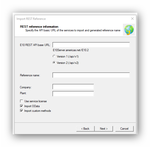

I’ve heard that SC now does REST. If true, that would eliminate that issue, no?

It does, and migrating to REST is on my back burner…way in the back, like 5th row back. We’re in the middle of bringing one of our child companies online in Epicor so once they’re live we’ll be able to revisit some clean-up tasks like using REST more and migrating a lot of our BPM logic into Epicor Functions.
Indeed, SC allows importing REST references from Epicor (SC 10.2.600 added support of REST v2; couple of versions before that got REST v1, IIRC), however when calling custom methods (as opposed to UpdateExt), adjustments may still be needed if a field required by the call was added between versions, and it is not transferred in Conversion created at the time where the field was absent.
Good thing about REST is that you do not need to keep matching client assemblies imported as .NET references to the version of ERP installation.
Good to know. We tend to upgrade slow here because of SC and updating the references always seems to break things and with REST, only signature changes would break things.
