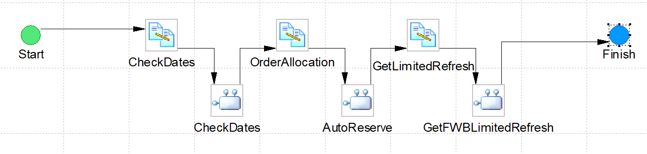

I am working on a SC workflow for auto-reserving orders. I followed the trace log and am using the methods that look they are doing the work. There are two primary methods. I hardwired the nodes in the dataset as the tracelog has the values and am feeding the order number information. The workflow does not error out but it doesn’t reserve the order release. I do have an ‘A’ on the first RowMod and a ‘U’ on the second RowMod, like the tracelog does.
The last refresh bit was added as an experiment and don’t believe is necessary.
I also tried to follow it in the BL Tester but it processes without error and doesn’t reserve the material, like the workflow.
There are a couple of object/Methods prior to the CheckDates on ClassAttributes but when I run them they all return nulls so they don’t appear to pass any data forward.
Anybody have any results with something similar or know what to look for?

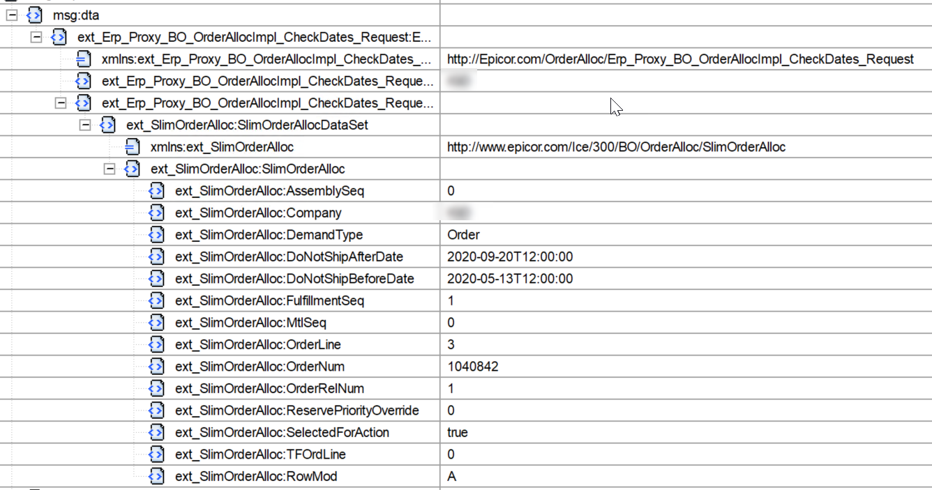

I do have the DemandType to Order and am not getting any errors out of cMessageText. Here is my conversion data:
Check Dates:
AutoReserve:
