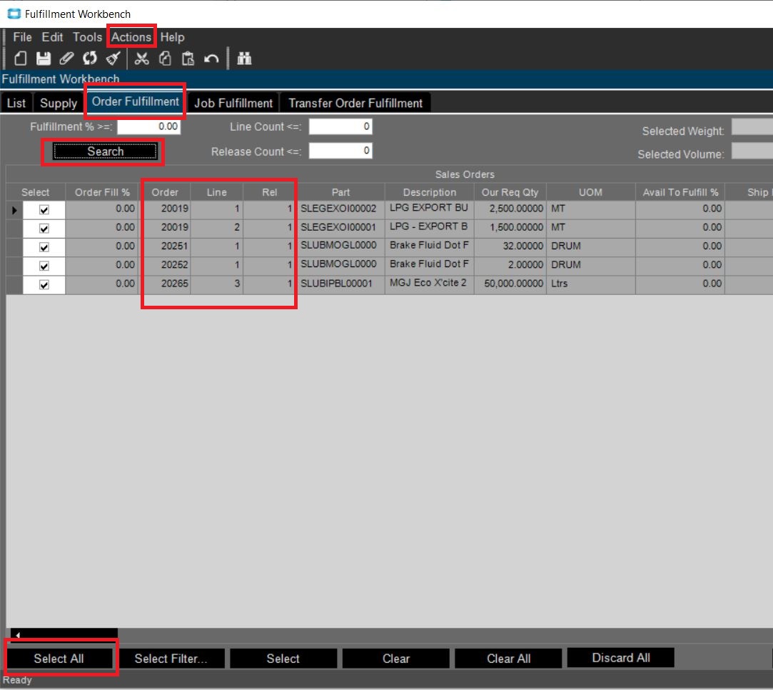

@Ricky, You can also reserve the multiple sales order on a single click using Fulfillment Workbench. Please follow the below-mentioned steps
  1. Open the Fulfillment Workbench
  2. Navigate to Order Fulfillment
  3. Click on the Search button and select the sales order based on filters
  4. Select All
  5. Go to Actions> Reserve > All Warehouses.

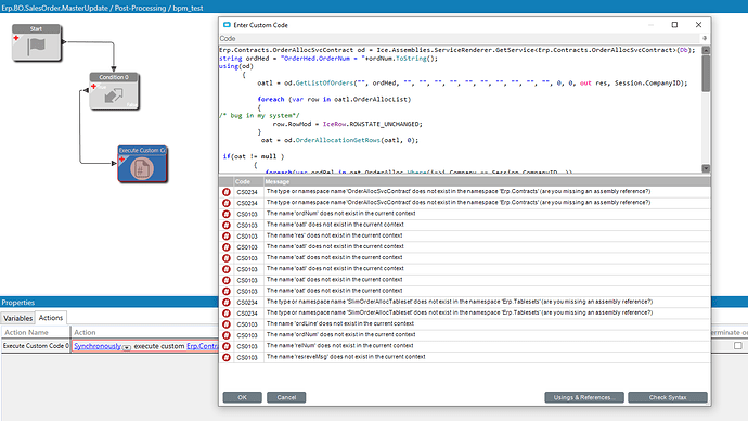

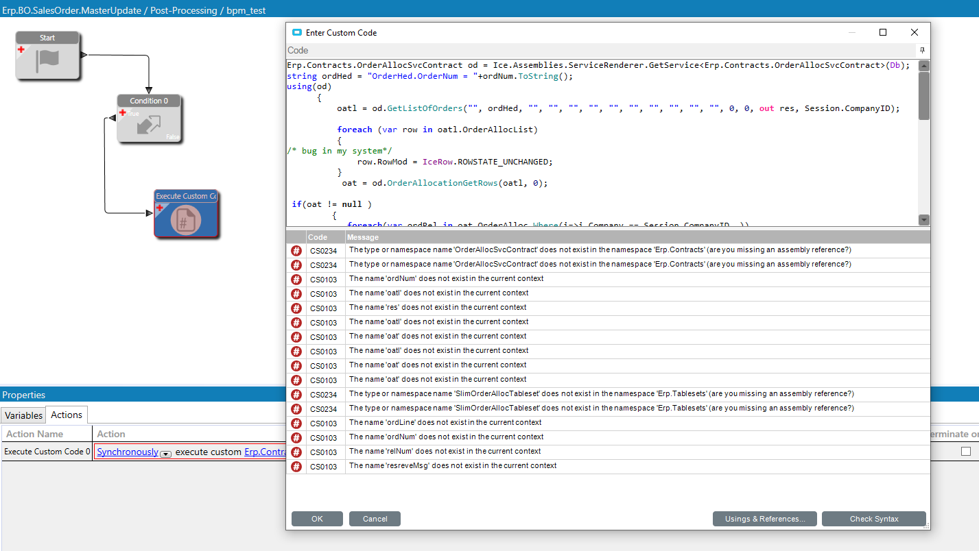

@prakash I have done so. but I seem to get plenty of error of fields not existing in the current context.
Edit** I have managed to remove the namespace error by adding ERP.Contracts.BO.OrderAlloc to the Usings and References but the rest of the errors remain.
you need to declare those variables and assign values.
@prakash
I have declared those variables.
I haven’t set any Values yet, is that using the Set Argument/Variable to just set the OrderNum, OrderLine and OrderRel values? or do i need to do an update table by query to fill the SlimOrderAlloc Tableset with the values from the code?

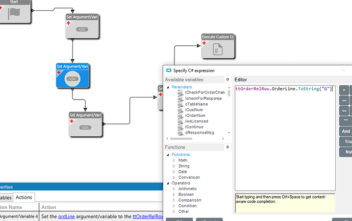

@prakash I set the Variables to values: see below as example for ordNum variable
I get this error when saving on the Sales Order Entry.

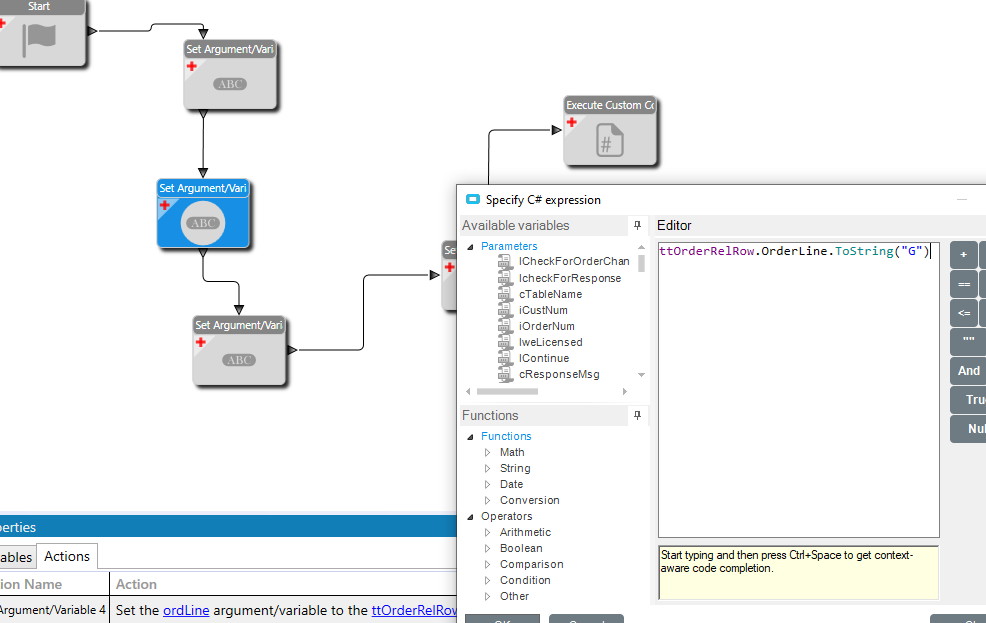

I invoked the BPM from the Standard Data Directive from the OrderRel table.
I used a condition that a UD field had to = true
I set the ordLine Variable to ttOrderRelRow.OrderLine.ToString() (I did the same with the ordNum and relNum variables + reservemsg was set to a message string. The only thing i didnt set was the false or true on the res variable. i get the below error.
