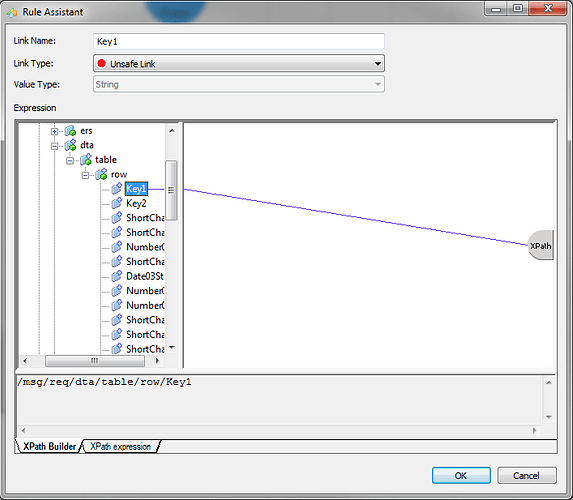

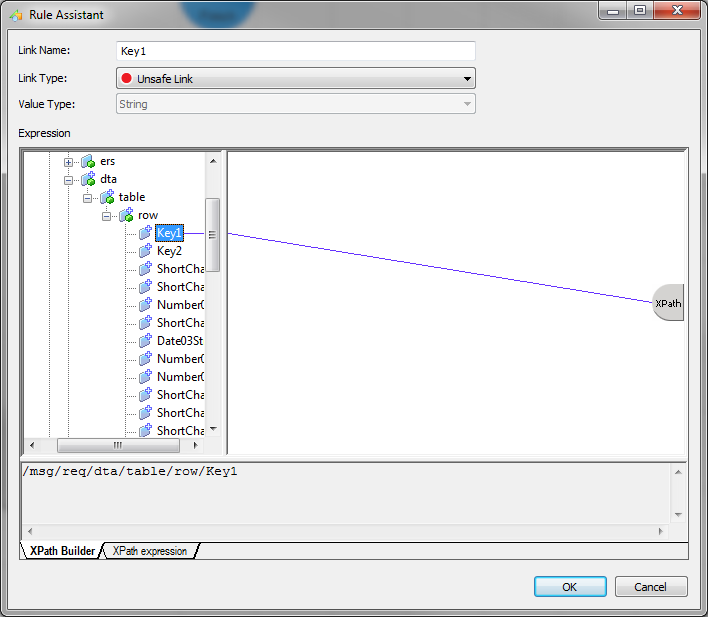

I’m trying to pass parameters into a stored procedure in a sub workflow.

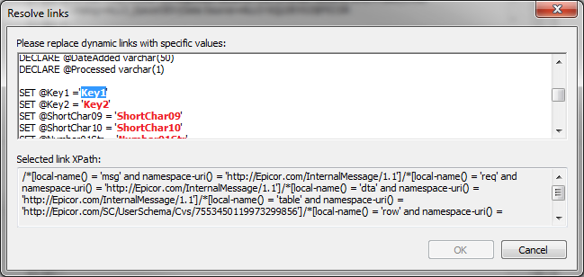

When I select output statement, I get this message:
I’m lost because the whole purpose of setting links is to allow dynamic links.
I’m sure I’m doing something incorrect, but I’m not sure what it’s asking me to do and why.
Any help is appreciated.
That message is to create the output schema. Enter any random text for each variable to complete the schema. Need not be valid data.

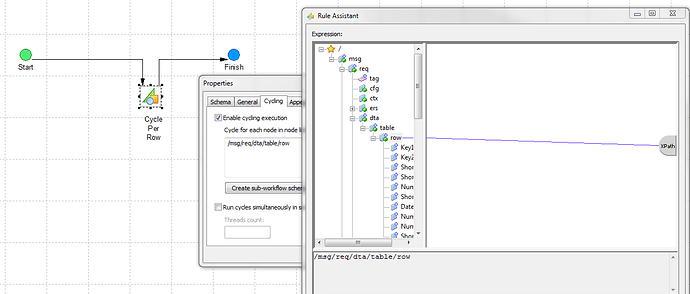

On my top level workflow, I’m making a call to a sub workflow and cycling the row element of the data coming in.
The sub workflow is inserting records into a database. This works correctly, however it is not inserting the data (creates blank record) and only cycled once. I’ve been trying to replicate my process like other functioning workflows that we have, but I must be missing something critical.
First thing that comes to mind is when defining the Cycling XPath, verify that the Row and not the RowSet is mapped to the XPath.
That doesn’t appear to be the case, but good suggestion.
