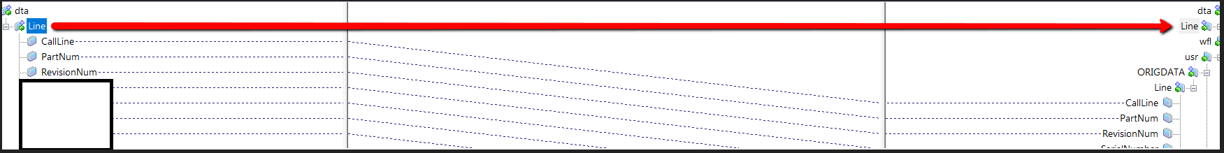

Trying to pass data through my workflow via XML. When I link from set to set like this (green lines):
I have my data, as soon as I try to manipulate any values or pass this way, my data is lost:
Why would this happen? I’m tearing my hair out haha.

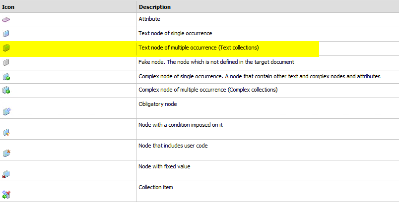

What Haso shows below… your nodes indicate Text node of multiple occurrence:
Thank you both for your help! It sounds like i’m trying to populate a node of multiple occurrence when it should be of single occurrence . Does this sound correct? If so, how do I make it single? I have a parent workflow cycling this workflow for each line. After mapping, I generated the schema for the subworkflow in the subworkflow “Generate Schema” button. The subworkflow is using the schema I created. Confused by how this would happen.
When I look at doc tracking. I see my data is in the Start Element just fine… i just can’t pass it through anything else… Why would the data be in the Start Element just as I want it, but as soon as I pass it through a conversion using the schema I generated in the SubWorkflow screen (cycling just as I want it to) the data is lost?
If this is in your subworkflow, then you need to pass the data to the dta, no?
its hard to tell, unless you post your flow with more sshots, xpath etc.

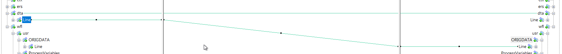

Lastly, I noticed when manipulating my values, their paths changed from:
To:
The first path would not work (no data passed), and the second one works flawlessly. I am not sure exactly where things went wrong. Perhaps someone with more XML experience can shed light on that? Just thought I’d mention this.
